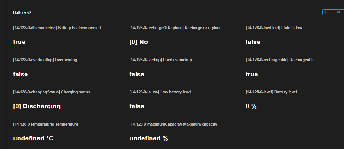

I’m using a ring outdoor siren with no rechargeable batttery integrated with zwave ui js
And I’m surprised to see that battery percentage is at 0% ?
Maybe this characteristic is for the rechargeable battery slot only ?
I noticed [14-128-0-rechargeable] Rechargeable is set to true (which shouldn’t be the case…)
I don’t mind the battery percentage to be honest but I was wondering if the warning and critical level will work ?
Am I missing something ?
Best regards
EDIT : I’m guessing the D battery are meant as “backup” battery not main source
the percentage barry is meant for the rechargeable battery
consumption of this device is rather low average of 75uA on sleep meaning if use for alarm purpose it gave you more than 10 years…
You could try refreshing the battery value perhaps the device will give you an update.
May I ask how do you do that ?
Press the refresh button in your screenshot. Then wait for the device to wake-up.
I tried no change
