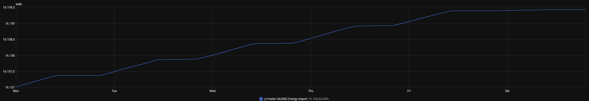

I have positive news for now, long term tests still to run.
As you can see in below screenshot, the daily consumption went down Friday around 10:15 AM from around 0,6 kWh per day to 0,04 kWh per day.
This is a huge improvement in my case for the total energy consumption per year and confirms my theory, that the zero point, if we can call it like that can basicaly be anywhere. The Solis support changed somethjing on my inverter via remote access. I do not know what but I try to figure out if this is a tweak in the firmware or just some changed settings.
I am very happy with this result. Still to be seen if the behaviour changes on shorter days, when the battery doesn't charge fully anymore during the day.
