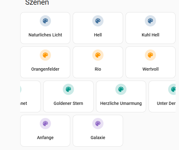

Thanks a lot. It was really helpfull. I got it now as I wantet:
I work with a hue bridge. Die Scenes are read out and sorted to rooms. In the first row are all standard scenes displayed. In the second, the scenes (except the standard scenes) have a brightness of 255 - 194, in the third 193 to 67 and in the last 66 to 0.
Here is my config, maybe it will help someone else:

  - type: custom:config-template-card
    variables:
      SCENES: |-
        //Nur folgende Szenen anzeigen und sortieren
         let customOrder = {
           'scene.wohnzimmer_naturliches_licht': 1,
           'scene.wohnzimmer_hell': 2,
           'scene.wohnzimmer_kuhl_hell': 3,
           'scene.wohnzimmer_energie_tanken' : 4,
           'scene.wohnzimmer_konzentrieren' : 5,
           'scene.wohnzimmer_lesen' : 6,
           'scene.wohnzimmer_entspannen': 7,
           'scene.wohnzimmer_ruhephase': 8,
           'scene.wohnzimmer_nachtlicht': 9
         Object.keys(states)
         .filter(
           k => k.startsWith('scene.wohnzimmer')
         .filter(k => Object.keys(customOrder).includes(k))
         .sort((a, b) => customOrder[a] - customOrder[b])
      SLIDESPERVIEW: parseFloat(states['input_number.dashboard_scenes_slidesperview'].state);
      MOMENTUMRATIO: >-
        parseFloat(states['input_number.dashboard_scenes_freemodemomentumratio'].state);
      MOMENTUMVEL: >-
        parseFloat(states['input_number.dashboard_scenes_freemodemomentumvelocityratio'].state);
    entities:
      - ${SCENES}
      - input_number.dashboard_scenes_brightness_1
      - input_number.dashboard_scenes_brightness_2
      - input_number.dashboard_scenes_slidesperview
      - input_number.dashboard_scenes_freemodemomentumratio
      - input_number.dashboard_scenes_freemodemomentumvelocityratio
    card:
      type: custom:swipe-card
      parameters:
        slidesPerView: ${SLIDESPERVIEW}
        spaceBetween: 8
        freeMode: true
        freeModeMomentum: true
        freeModeMomentumRatio: ${MOMENTUMRATIO}
        freeModeMomentumVelocityRatio: ${MOMENTUMVEL}
      cards: |-
          let cards = [];
          SCENES.map(entity =>
            cards = cards.concat(
                'type':'tile',
                'entity':entity,
                //Anzeige formatieren -> Ohne _ und Anfangsbuchstaben groß schreiben
                'name': entity.replace("scene.wohnzimmer_", "")
                  .replaceAll("_", " ")
                  .split(" ")
                  .map(w => w
                    .charAt(0)
                    .toUpperCase() +
                    w.slice(1))
                      .join(" "),
                'vertical': true,
                'hide_state': true,
                'tap_action': {'action': 'toggle'}
          cards;
    variables:
      SCENES: >-
        let allScenes = Object.keys(states)
        .filter(
         //folgende Scenen herausfiltern und restliche Aplhabetisch sortieren
        .filter(k => ![
          'scene.wohnzimmer_naturliches_licht',
          'scene.wohnzimmer_hell',
          'scene.wohnzimmer_kuhl_hell',
          'scene.wohnzimmer_energie_tanken',
          'scene.wohnzimmer_konzentrieren',
          'scene.wohnzimmer_lesen',
          'scene.wohnzimmer_entspannen',
          'scene.wohnzimmer_ruhephase',
        ].includes(k)).sort()
        // Szenen die trotz Helligkeitsfilter dargestellt werden sollen
        let mustInclude = [
          'scene.wohnzimmer_kuhl_dummy',
          'scene.wohnzimmer_galaxie_dummy2',
          // usw.
        allScenes = allScenes.filter(sceneID => {
          // 1) Falls die Szene in mustInclude gelistet ist
          if (mustInclude.includes(sceneID)) {
            return true;
         //Nur Szenen anzeigen die Zwischen den Helligkeitswerten liegen
        let B1 =
        parseInt(states['input_number.dashboard_scenes_brightness_1'].state);
        let B2 =
        parseInt(states['input_number.dashboard_scenes_brightness_2'].state);
        let brightness = states[sceneID].attributes.brightness;
        return brightness && brightness > B1 && brightness <= 255;
      MOMENTUMRATIO: >-
      MOMENTUMVEL: >-
    entities:
      - ${SCENES}
    card:
      parameters:
        spaceBetween: 8
        freeMode: true
      cards: |-
          let cards = [];
                'type':'tile',
                'entity':entity,
                  .split(" ")
                  .map(w => w
                    .charAt(0)
                    .toUpperCase() +
                    w.slice(1))
                      .join(" "),            'vertical': true,
                'color': 'orange',
                'hide_state': true,
          cards;

    variables:
      SCENES: >-
        .filter(
        .filter(k => ![
        let mustInclude = [
          // usw.
            return true;
        let B1 =
        let B2 =
        return brightness && brightness > B2 && brightness <= B1;
      MOMENTUMRATIO: >-
      MOMENTUMVEL: >-
    entities:
      - ${SCENES}
    card:
      parameters:
        spaceBetween: 8
        freeMode: true
      cards: |-
          let cards = [];
                'type':'tile',
                'entity':entity,
                  .split(" ")
                  .map(w => w
                    .charAt(0)
                    .toUpperCase() +
                    w.slice(1))
                'color': 'teal',
                'hide_state': true,
          cards;
    variables:
      SCENES: >-
        .filter(
        .filter(k => ![
        let mustInclude = [
          // usw.
            return true;
        let B1 =
        let B2 =
        return brightness && brightness >= 0 && brightness <= B2;
      MOMENTUMRATIO: >-
      MOMENTUMVEL: >-
    entities:
      - ${SCENES}
    card:
      parameters:
        spaceBetween: 8
        freeMode: true
      cards: |-
          let cards = [];
                'type':'tile',
                'entity':entity,
                  .split(" ")
                  .map(w => w
                    .charAt(0)
                    .toUpperCase() +
                    w.slice(1))
                'color': 'purple',
                'hide_state': true,
          cards;
title: Szenen
visibility:
  - condition: state
    entity: input_boolean.dashboard_scene_configtemplate
    state: "on"
