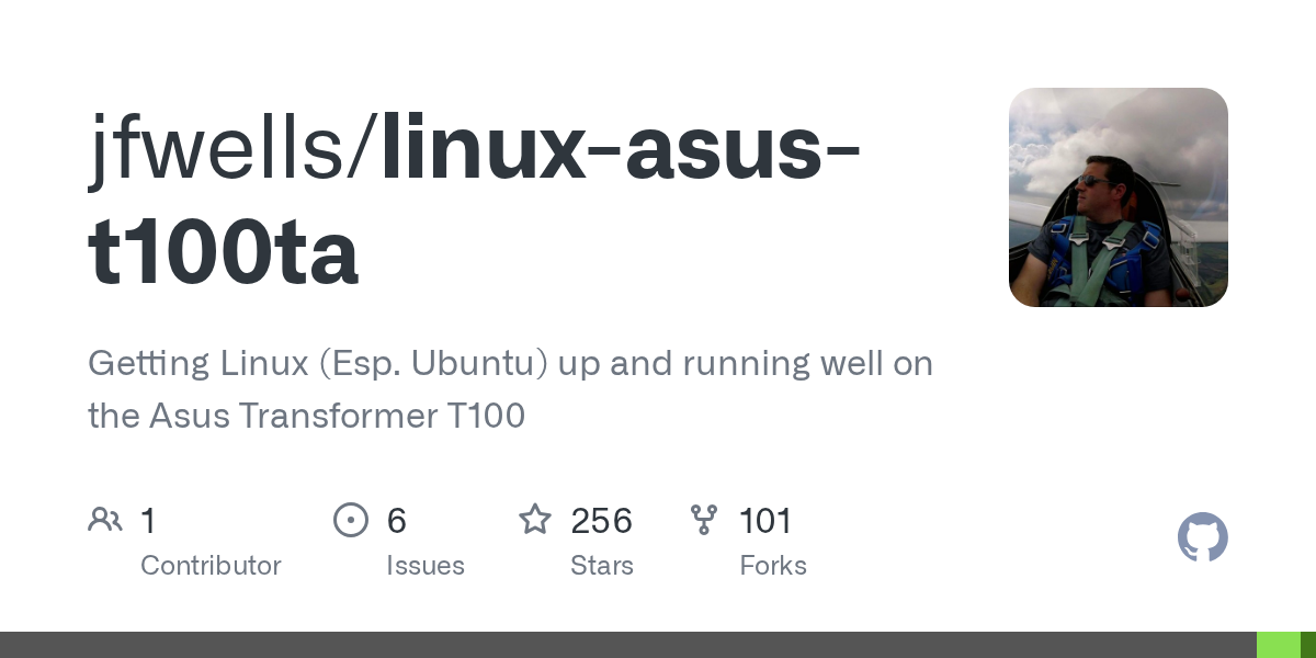

And finally, I installed.touchkio. So, for 300 CZK, you get a functional control panel with voice control—but it occasionally freezes or shuts down, and the speed isn’t exactly blazing, though it is usable. If you’re thinking of trying something similar, I’d recommend paying a bit more for a device with at least 4GB of RAM and definitely avoiding anything with an Intel Bay Trail processor. It won’t cost 300 CZK, of course, but it will save you a lot of hassle and provide a much more pleasant user experience. However, if you do want to go down this route, look at the Asus T100TA instead of the Acer Iconia; it has a larger community behind it, and you can find guides and patches specifically for that model online.
