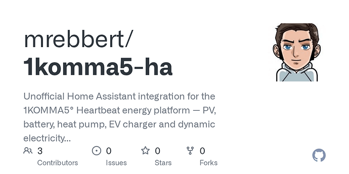

Hi everyone,
:warning: this integration was built entirely with AI assistance (vibe-coded).
I built an unofficial HA integration for 1KOMMA5° Heartbeat — a German home energy platform combining PV, battery, heat pump, EV charger and dynamic electricity pricing.
I was already aware of the existing hacs_1komma5grad integration, but was missing a few things - so I started this as a vibe-coding experiment, and it turned into a surprisingly complete integration.
What you get:
  • Live power sensors for PV, battery, grid, consumption, EV charger, heat pump (30 s)
  • Energy sensors (kWh) for the Energy Dashboard
  • Electricity cost & feed-in revenue sensors (dynamic pricing)
  • 30-hour price forecast + cheapest-hour attribute
  • Binary sensor: ON when price is below today’s average
  • EV charger controls (charging mode, target SoC, departure time)
  • EMS auto mode switch
GitHub:
Let me hear what you think.
Thanks & Best Regards,
Markus
