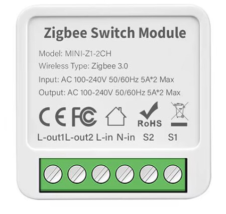

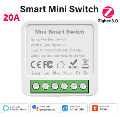

My controller is kind off:
Are you sure the picture is correct? To me this seems like a single channel controller.
Picture is just to show that is cheap controller from aliexpress. I have 2 channel controller

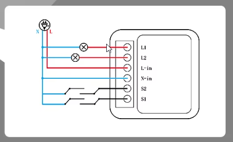

It would probably help if you explained how you have connected everything and what kind of controller it is.
That is the switch which I have
and it is connect like that
Common problem with Tuya stuff unfortunately. Both switches point to the same cluster/endpoint & end up controlling each other.
There's other similar topics if you search these forums & zigbee-herdsman on github. Unfortunately the solution to this is to create your own custom quirk or adapt an existing one to use your model, which is quite a stretch if you're just starting out.
