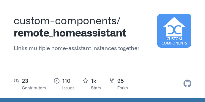

I think it will be overkill, but you can try this integration
