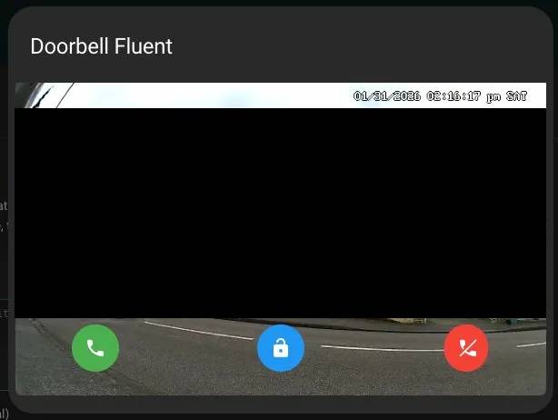

I did some testing this morning without an open gate script. I still don’t know what that is.
If I ring my doorbell I get the pop up on my phone as expected but I am not getting it on my wall mounted fire tablet that is running fully kiosk, even though both devices are registered in browser mod.
On my phone the pop up looks great with audio and video but when I press the green button to activate the two way communication I get a gray screen with a red error message telling me I have a configuration error.
What am I missing?

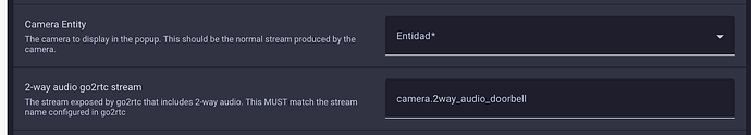

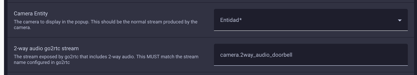

If you read the guide, you have to select:
  1. in the first field the camera entity provided by the Reolink integration and
  2. in the second field just write the name of the stream defined in go2rtc. In your case your stream name already matches the default value so no need to modify it:

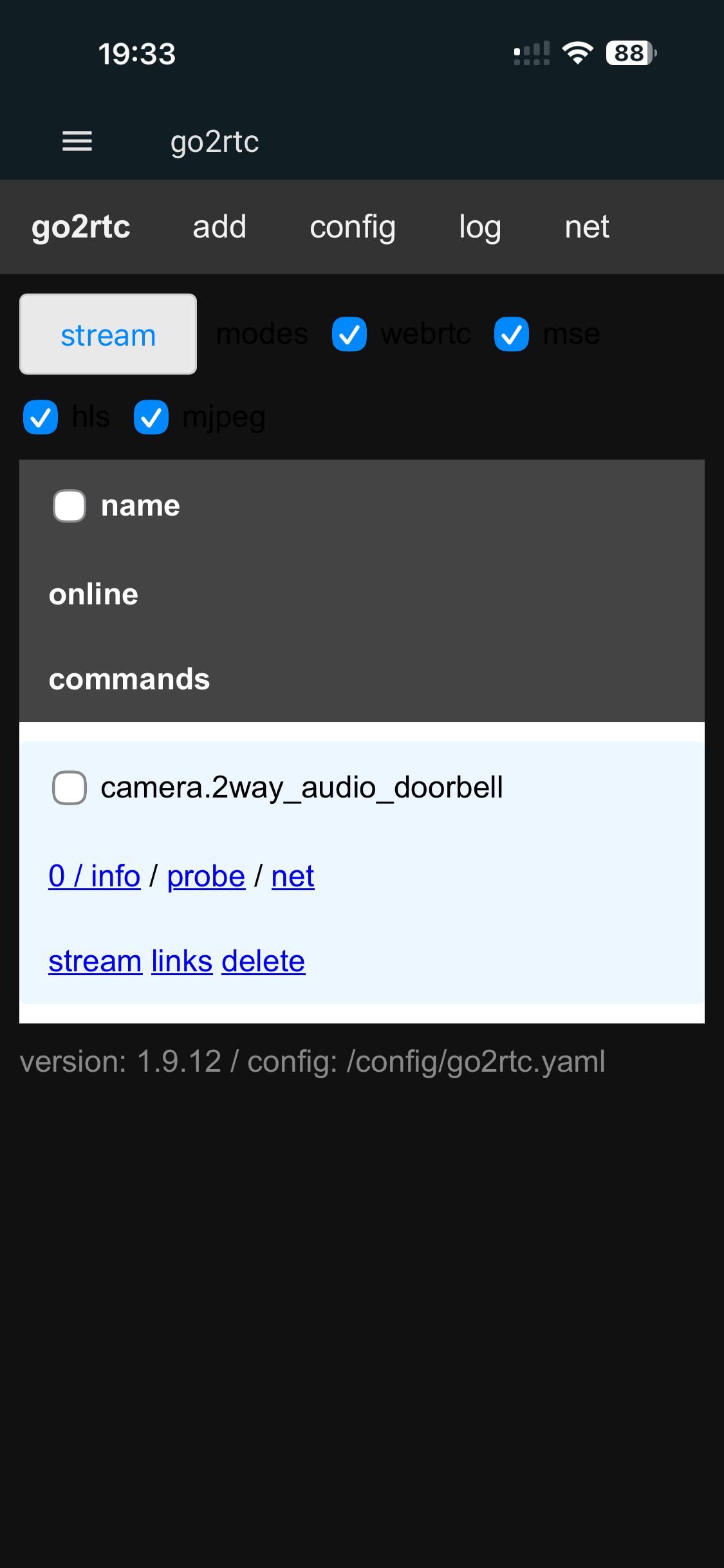

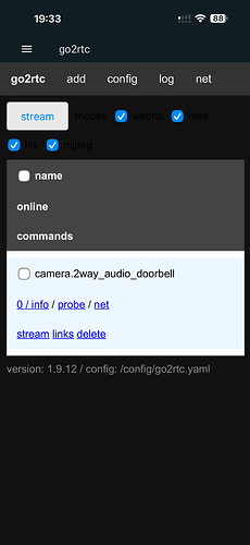

So I am an idiot.

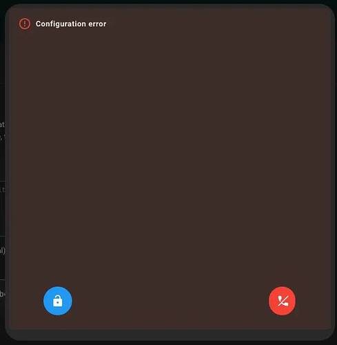

If you get the “Configuration Error” message or when clicking the ‘call’ button for 2-way talking or when just adding a card to the dashboard for testing and you get this “Custom element doesn’t exist: webrtc-camera”, MAKE SURE YOU ADDED THE WEBRTC INTEGRATION!
I didnt because I didnt know I needed to. 2 days… 2 DAYS I was working on this!. I happened across this issue on the webrtc github: Custom element doesn't exist: webrtc-camera · Issue #260 · AlexxIT/WebRTC · GitHub
Someone mentioned my same issues. Then I remembered that I had to add go2rtc to get that working so I added webrtc and BINGO!
For context, I am a full stack dev so I know my way around code. But I only installed HA 3 days ago. Still learning.
Now I just have to work out why there is so much delay between saying something and hearing it on the doorbell.
Hi all,
thanks @victorigualada a lot for sharing this project and the blueprint.
If anyone suffered from the issues described above, here’s the updated version of the blueprint (tags and “new” way o closing popups added) which eliminates all of them:

I have a problem where the first popup window doesn’t display the reolink video feed from my doorbell. if I click on the green telephone icon to accept the call a second popup window appears which does have video on it and it does seem to pass audio back to the doorbell (although currently it doesn’t seem to work the other way round, but I think this may be a problem with web RTC)
I have tried adding a generic camera device manually (pointing to the Reolink rtsp address and the entity itself shows the video feed) but when selecting it as the primary feed for the first popup it still doesn’t work. It just says configuration error.
The Reolink integration shows the fluent and clear video feeds no problem.
The 2 popup windows appear to be using 2 different type of feeds, the first using the camera entity directly and the second using webrtc/go2rtc.
Any ideas would be much appreciated.
Thank you.
