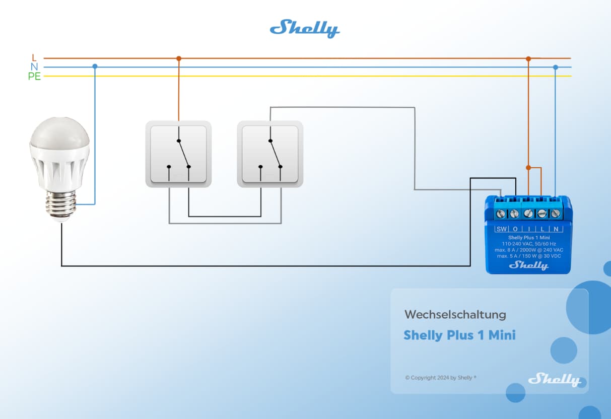

In order for us to help you it might be worth to provide two types of information:
In which country are you located?
What does your wiring diagramm look like?
If you are located in Europe this is what your wiring should look like:
thankyou, i think thats where i went wrong, i ended up parralelling the light feed which obviously was causing me to power the lights full time unless i turned off via app.
thankyou so much for that diagram, it clears it up for someone whos had little sleep.
