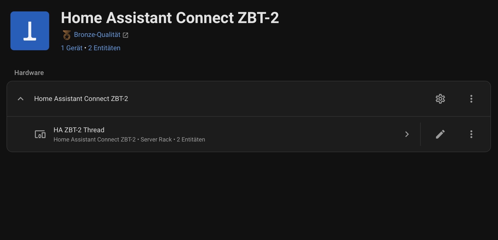

I also solved the problem by using usb by port not by device on proxmox. Zigbee and thread working fine. BUT: now I have the problem, that only 1 zbt2 is showing as a device. The zbt2 with thread fw is showing just fine as a device and I can see firmware update etc. the second zbt2 with zigbee fw is only showing under zha but not as a device like the thread zbt2. So I won’t be able to update fw on the zbt2 with zigbee fw because it is not showing as a device for its own.
