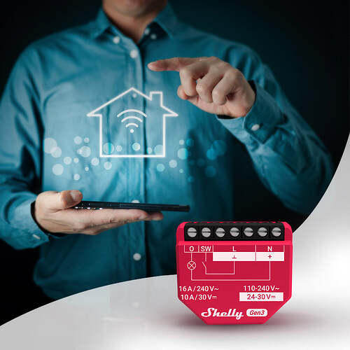

also not a ‘switch’ but shelly has a variety of relays that might suite your needs
