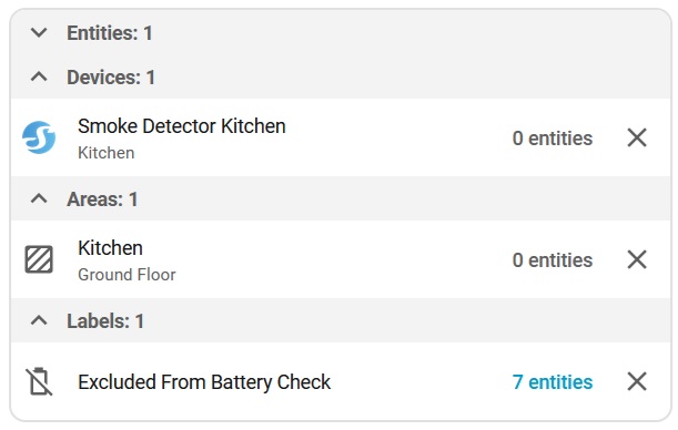

This is likely feedback more suited for the Target selector developers. I have a blueprint, :low_battery: Low Battery Notifications & Actions, that uses the target selector under Battery Settings > Excluded Battery Sensors. It lets you exclude batteries using Areas, Devices, Entities, and Labels. It is also the same outcome for another input in the blueprint that allow you to add a custom group of batteries called Battery Sensors - Custom Group.
Entities and Labels display their entities correctly. But, Areas and Devices show no entities, even though those Areas and Devices definitely contain battery sensors. The blueprint itself works and successfully excludes or Includes the entities, but the UI doesn’t show them, which makes it look like the Areas and Devices don’t have any entities.
I’ve checked the documentation and can’t see if I am doing it wrong, so I’m unsure whether I’ve misconfigured something or if this is a bug.
