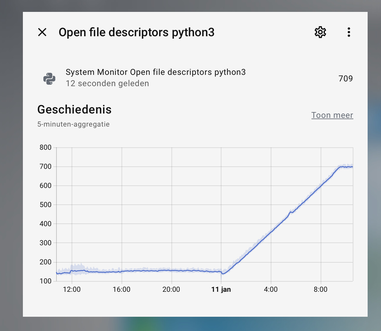

I had been getting the file descriptors problem back on a structural base for some time after an initial calmer period.
so. much so, I had to restart quite frequently to make them go back to a normal number, only seeing them go up again structurally. Mostly during evening times (was that a hint…) but not always, (guess no hint then)
then 2 things happened:
  • Solaredge broke the api endpoint used by CC Solaredgeoptimizers. So I took that CC out
  • 2026.1 beta started, which returns the home-assistant.log (if you decide to ). So, I also took out the CC @petro did for us to temporarily bring back the lost log file.
Lo and behold, after that, no more file descriptors issue at all…
too bad I didn’t realize it while uninstalling… no I’ll never know which of the 2 was responsible :wink:

there is a lot going on with the SolarEdgeoptimizers CC, and I’ve reported there, but, given the fact it has nothing to do with the latest developments, and had been there before, I fear it wont be fixed anytime soon
I have one more CC to test to be sure (Waterinfo), which was also updated recently, so will be able to tell tomorrow after that has been taken out.
update

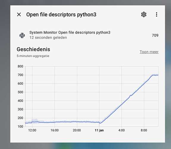

turns out it is the Bluetooth Proxy, which on course is what the filed logs already showed…
turning 1 of these proxies off immediately starts the increase, and vice versa
Its what happens during night time here (because there is a horrible light on one of them in my bedroom…)
