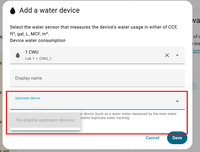

Devices can only have other individual devices as upstream (not the main water meters). Do you have mulitple individual devices configured?
Yes, I have about 50 end water devices in HA, few sub-meter water meters (for cold and hot water for some areas) and one main supply. I try each of them without success.

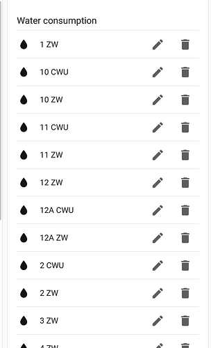

Right now under " Water consumption" section I have only 50% (about 25) of end water meters configured as shown on picture. Second part of end-water meters (~25 devices) and all sub-meters and main are not configured in this section.

"device_consumption_water": []
So according to this you haven’t yet added any devices as individual water devices.
Only individual water devices can be selected as upstream devices, so you must add some individual devices before you can see any options there.

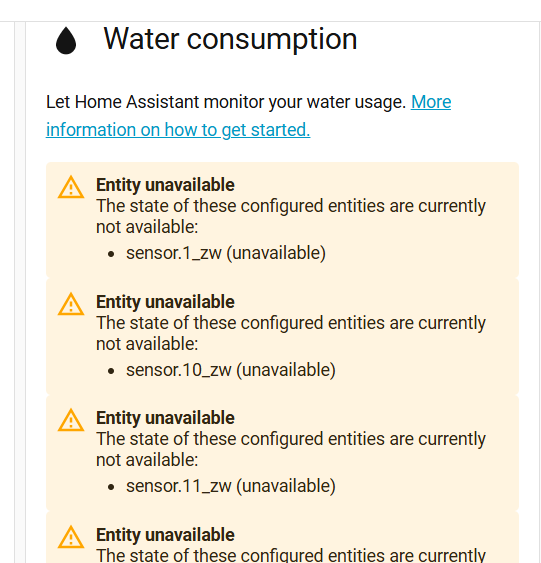

PS. Not sure important but due to temporary fail one of my many WM-Bus readers I have some end-water device configured in energy dashboard in such status

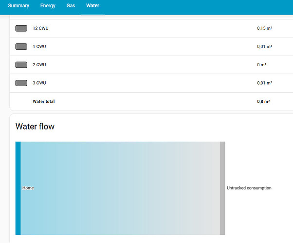

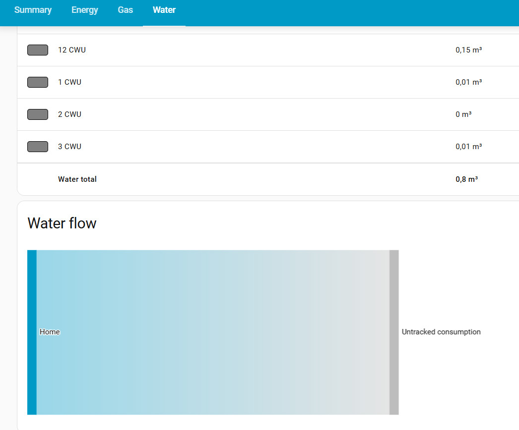

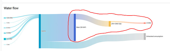

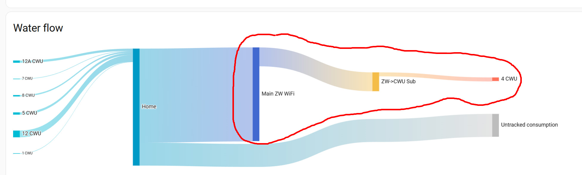

After add one “stream” from end water meters to source then nothing

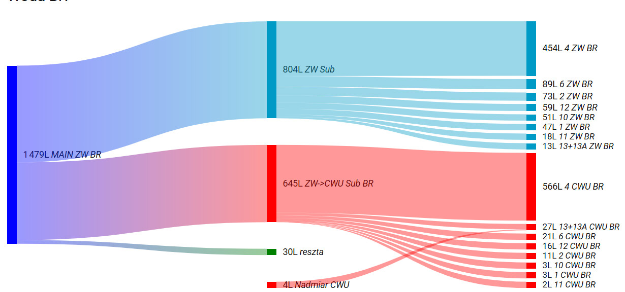

I believe “red” stream from my custom Sankey will looks similar but unfortunately no, can you please look on my current config (the same link as earlier) and tell me why?
I made some test and in my opinion there is a bug.

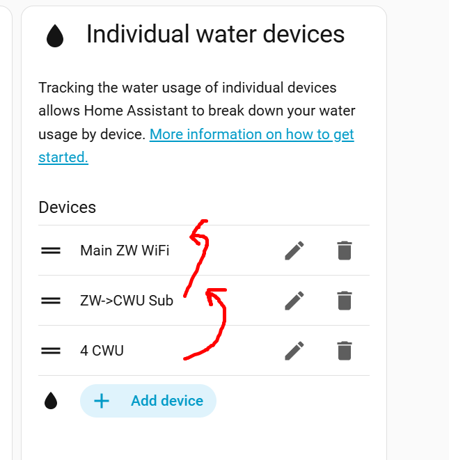

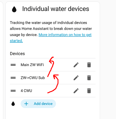

My simple config is

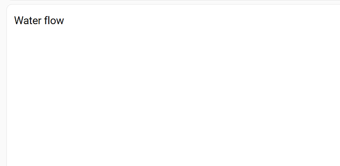

“Main ZW Wifi” → “Zw->CWU Sub” → “4 CWU”

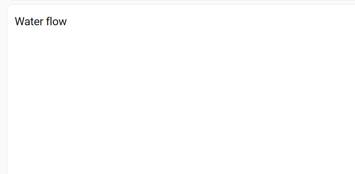

But when end-meter (in my case “4 CWU”) I add to " Water consumption" then empty screen:
