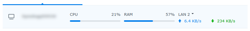

I tried again. VM at steady-state:

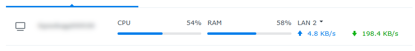

VM at ~75% core upgrade progress:
The CPU usage spiked to 64% for a moment I think during the install, but that was as exciting as it got. RAM utilization never went above 59%.

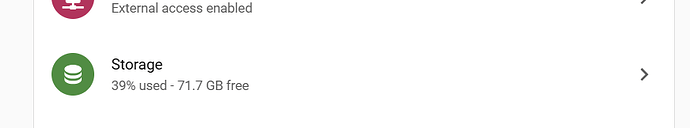

Also relevant, I guess:

Just wanted to chime in having the same problem (HA running in VM with plenty of storage and memory available).
