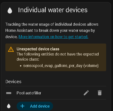

Hi all, asking for a quick sanity check here if I’m doing something wrong or it’s a bug. I created (water) utility meter for my pool autofiller and it’s working well. However when I try to add it to the energy dashboard under individual water devices, I get this little number:

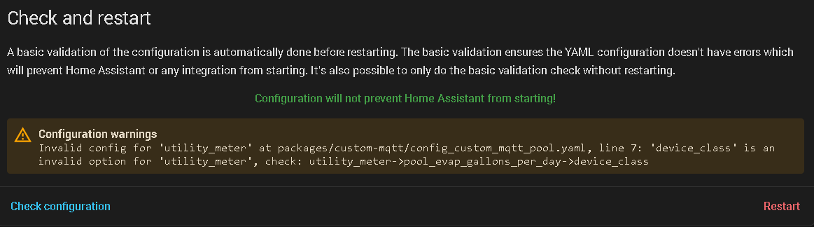

Even though it’s not listed as a config variable, I tried adding the device_class in my YAML definition as follows:

However, when checking the YAML in dev.tools, it not entirely unexpectedly yells at me:

I think you will find that Home Assistant device class “water” [Water consumption in L, gal, m³, ft³, CCF, or MCF] is going to be more acceptable than “volume”
Thanks for the suggestion - I gave that a try, yet the utility meter entity does not like having a device_class configuration entry added, be it water or volume:
I tried changing the underlying sensor to device_class water unfortunately that has no effect on the issue that the energy dashboard won’t accept the utility meter.
Note: Reading about the energy panel and adding sensors, it actually looks like utility meters are not supported? This seems weird as it would not be unusual to have sub meters for irrigration and other water consumption points, as well as sub electricity-meters, for like an guest house or inlaw-unit?

Yes it appears that the Energy Dashboard will only accept sensors, and the state_class has to be total / total_increasing, and for the Water the device_class has to be water, and the units gal.

Don’t add the device class to your Utility Meter. That is not supported. The only valid options are listed in the documentation here: Utility Meter - Home Assistant
You add the correct device class to the source mqtt sensor.

The utility meter then uses this to populate its own device class.
For this to happen you will probably have to delete the utility meter yaml. Restart. Then delete the residual utility meter from Devices & Services → Entities. Then recreate your utility meter and restart again.
Or it may be a FIX ISSUE you can do in Developer Tools → Statistics.
