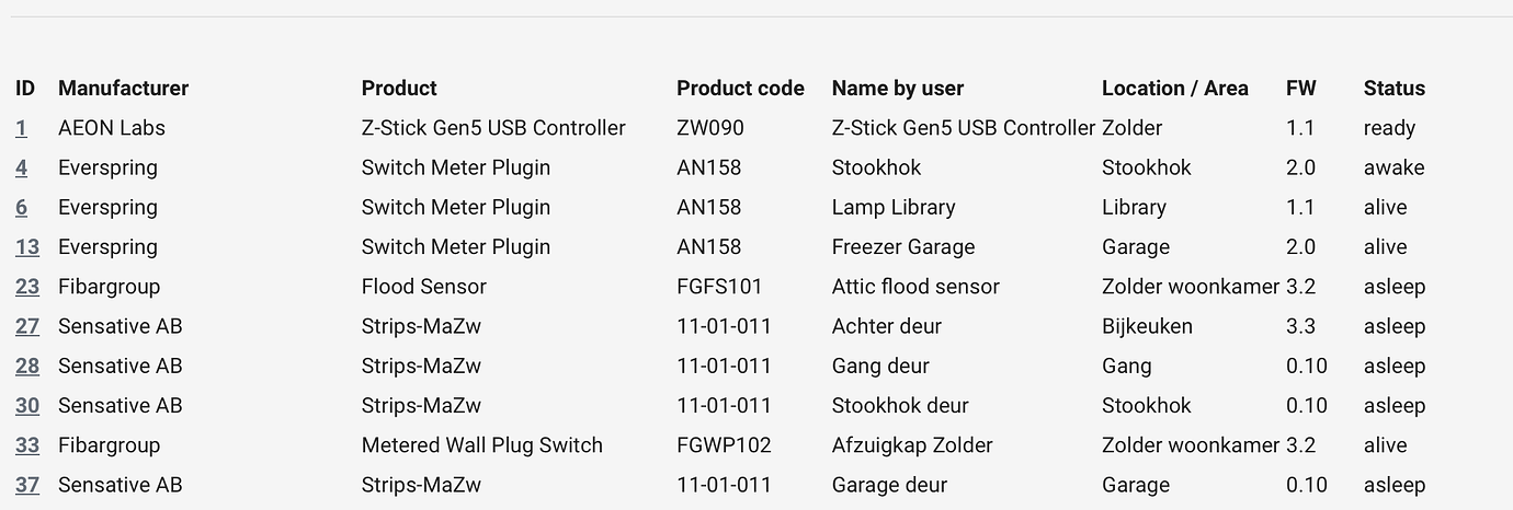

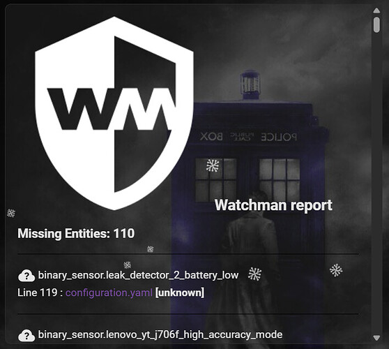

in 2025.12 several changes have been implemented that cause my markdown tables and indents (block quotes) to change their appearance.
the block quotes are or, instead of an indent I now get this vertical line:
which is not too bad… Id rather not have it, but apparently now the card follows specifications it previously didnt :wink:

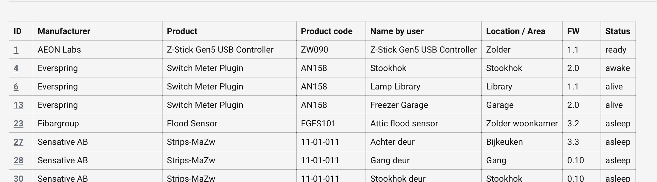

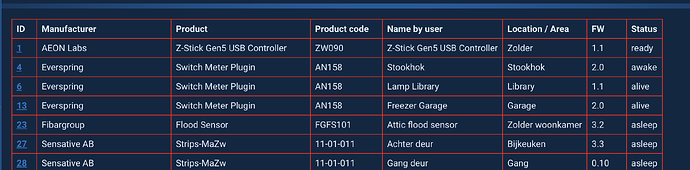

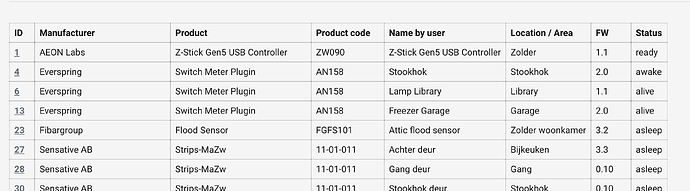

the tables however now show borders around all of the cells (which they now appear to be, like an excel sheet) and I really dislike that.
before:
now
my original wa using the --|--|-- syntax with this template

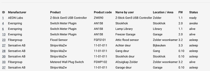

and I was told to use html and style the table, so I tried that with

but the result is identical somehow…
would anyone be able to spot where I go wrong?

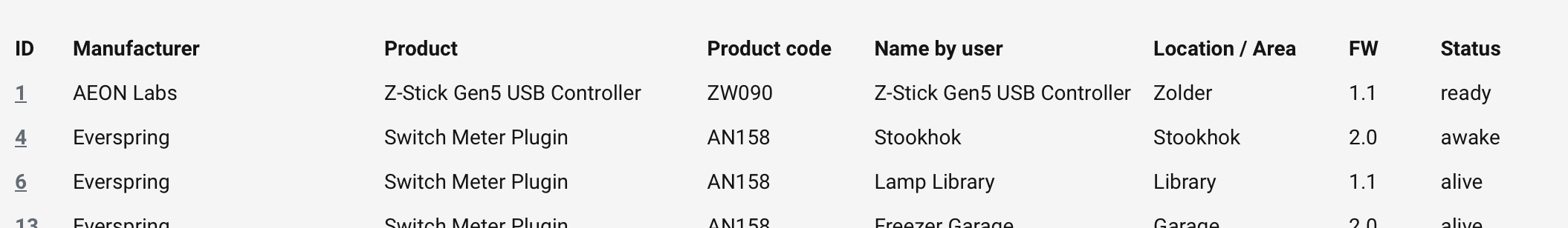

just learned that we can set
markdown-table-border-color: transparent
in our themes, or use ā€˜ā€“markdown-table-border-color: transparent’ in a card-mod styling and the borders are gone. Well, transparent…
As Petro said in the beta Discord channel, the border setting is likely better set at td (cell) level anyway, rather than table level EDIT: for html tables. The theme variable likely works for markdown code.
My posted code does work, just not reliably on first load.

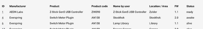

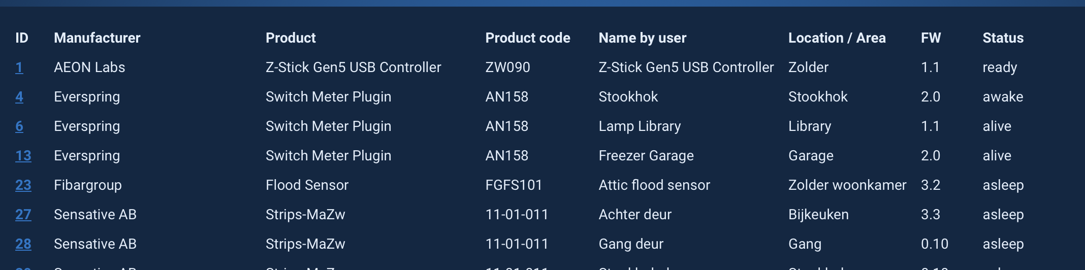

I just confirmed in the beta channel that setting
#     markdown-table-border-color: transparent
    markdown-table-border-width: 0px
in the generic theme settings (so not card-mod theming, nor card_mod) effectively removes the borders in both the markdown style and table html style
the styling in the html markdown is effectively ignored, so I changed that to

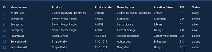

you can easily test the power of these theme vars.
set
markdown-table-border-color: red
and next, add
set to width 0px, the red borders no longer exist :wink:

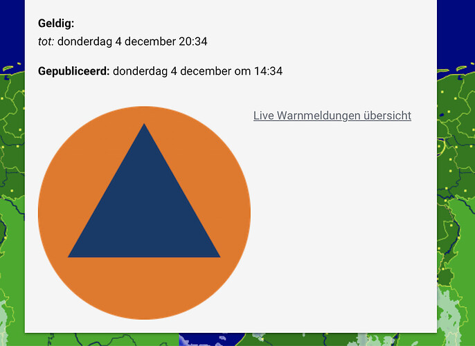

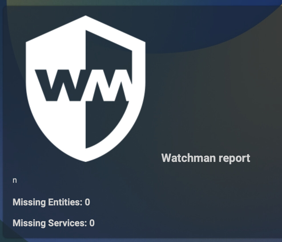

only now do I discover this huuuge icon in Markdown…
  - type: markdown
    content: >
      <img src='/local/images/mowas.png' width='35'> [Live Warnmeldungen übersicht](https://warnung.bund.de/meldungen)
