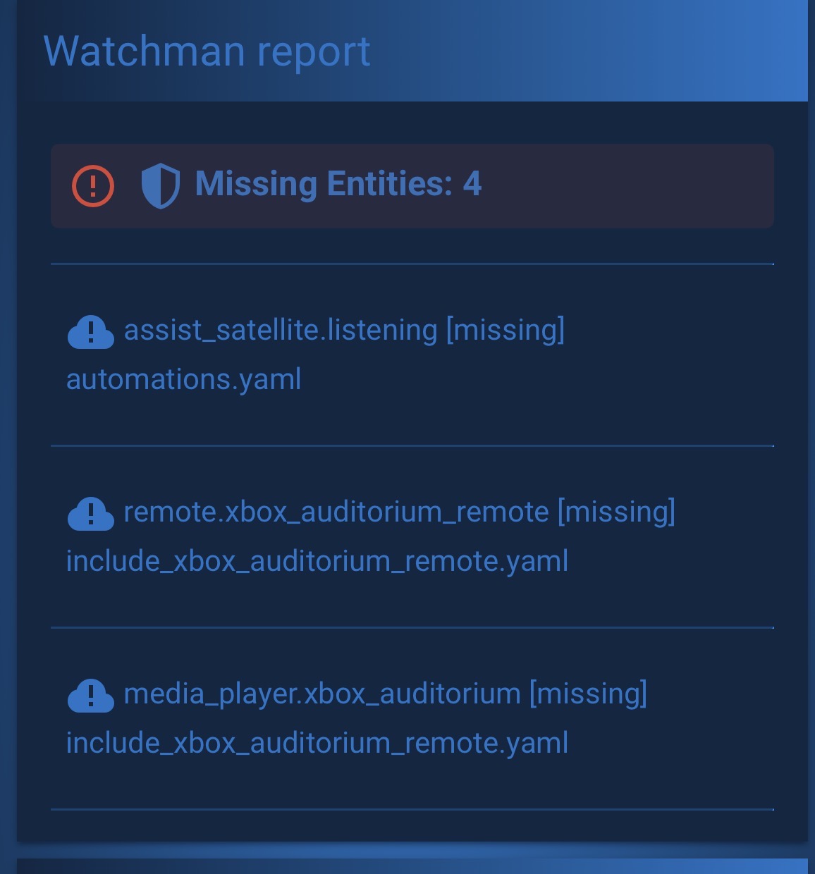

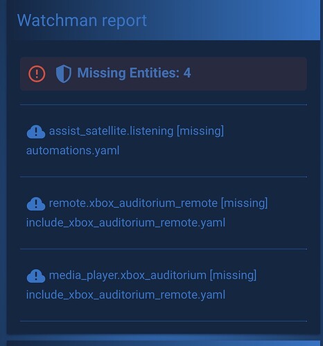

Funny that is about the only card that isn’t affected in my config…
What is your Yaml for that particular card @Mariusthvdb
type: vertical-stack
card_mod:  !include /config/dashboard/card_mods/stack_card_gap_shadow.yaml
visibility:
  - condition: numeric_state
    entity: sensor.watchman_missing_entities
    above: 0
cards:
  - type: heading
    heading: Watchman report
    card_mod:
      class: class-heading
  - type: markdown
    card_mod:
      style: |
        ha-card {
          overflow-y: scroll;
          max-height: {{states('input_number.max_scroll_hoogte')}}px;
          color: var(--primary-color);
    content: >-
      {% set missing = states('sensor.watchman_missing_entities')|int(-1) %}
      {% set type = 'error' if missing != 0 else 'info' %}
      <h3><ha-alert alert-type={{type}}><ha-icon icon=mdi:shield-half-full></ha-icon>
      Missing Entities: {{states('sensor.watchman_missing_entities')}} </ha-alert></h3>
      {%- for item in state_attr('sensor.watchman_missing_entities','entities') %}
      <hr> <table><tr> <td>
      <ha-icon icon=mdi:
      {%- if item %}
        {%- if item.state=='missing' -%} cloud-alert
        {%- elif item.state=='unavail' -%} cloud-off-outline
        {%- else -%} cloud-question
        {%- endif -%} ></ha-icon>
      {%- else -%} help
      {% endif %}
      {{item.id}} [{{item.state}}] <a title='{{item.occurrences}}'>
      {{item.occurrences.split('/')[-1].split(':')[0]}}</a>
      </td></tr></table>
      {% endfor %}

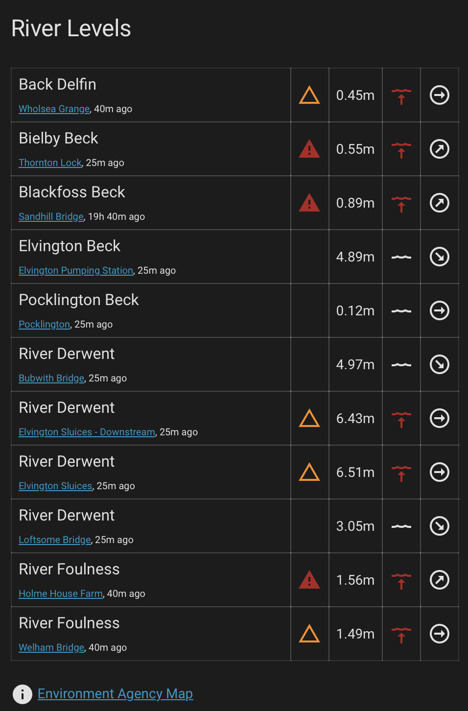

The tables are aligned again, but the border still appears, even when set to “0”.
As for the images, they no longer respect the size settings that worked before.

This shouldn’t need to be done by creating a theme just for this tweak.
Using <table><tr><td>blah inside a markdown card has been a really good way of laying out complex displays on a dashboard card - now it just looks like a spreadsheet.
Bit lost as to why anyone thought this would be a good idea to change it but ho hum…
