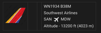

I still have the table problems in my markdown cards, which showed up after the 2025.12 update.
What problems (describe them instead of posting a picture)? Have they been written up?
It’s the original issue in the first post where borders are showing up around tables. I assumed the fixes coming included reverting the changes that resulted in the borders showing up.
There are mentions of changing the general theme to remove them. If this is the only way this will be resolved, then I think it would help clarify that the recent frontend updates fixed the image sizing problem (which I can confirm is fixed) but to fix the borders not being invisible anymore we need to make changes to the theme.
That issue has not been addressed yet.
also apparently adding:
markdown-table-border-width: 0
to your theme will remove the borders.
Thank you. That did it.
In my case I have a themes folder in my home assistant folder that is included in the main configuration yaml, so to apply this fix I created a new folder under theems, added a new filename.yaml, and then added this line underneath the name of the theme.
For me the folder is Default, the file name is Default.yaml and the contents are
Default:
    markdown-table-border-width: 0px
I then selected this new Default theme for all the dashboard tabs that have the issue. I was using No theme for all of them before.
