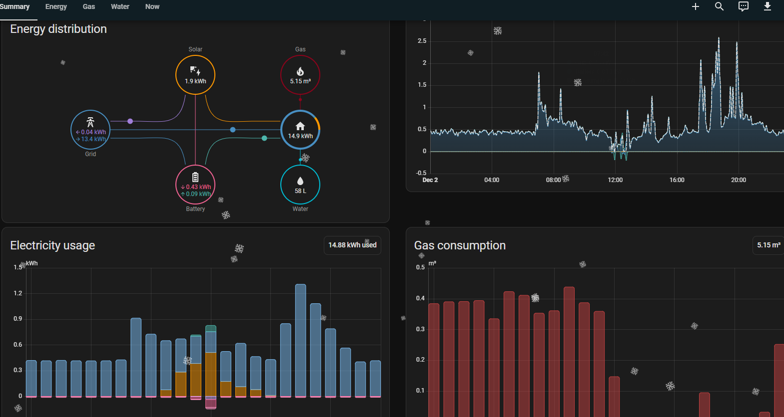

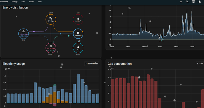

How is the solar ‘now’ power working? i never see it in the new power graph? as example below…
I added the power source as below , its a HomeWizard KWH meter for my solar… is it maybe because the power sensor does have negative values? Normally not, cause the grid power also has negative value when i’m returning to grid …

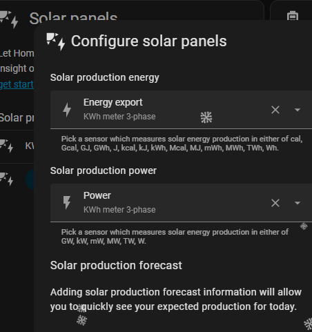

did you also add the “solar production power” entity in the solar panel configuration like i did? How are you measuring solar? also a negative value?
that was the right hint! I needed to update energy and power sensor names in my solar input! they both had the same name which broke it.
now it works fine :smiley:

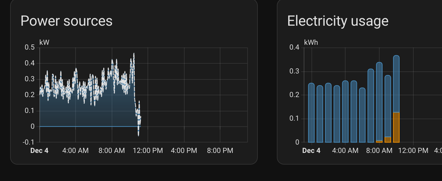

hmm, why dont i see the graph then
can you show me screenshots your config?
is same as yours, did you make sure top/energy is in WH and bottom/power is in W, that was my problem, both were W.
My export is in kWh and the power in W, shouldt be the issue :frowning:
Is your W sensor in positive or negative?
power sensor electricity meter is negative when i export and positive when i import energy. solar power sensor is allways positive
yes, fixed here also, seems my homewizard integration creates negative for solar…
created a new template sensor that inverts it, now fixed!
