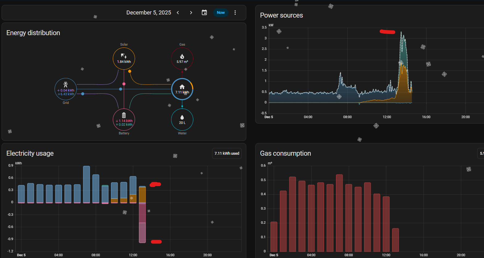

Hi, since we now can configure power sources , are those wrongly calculated?
Look at example below, sun was finally shining i use like 0.4 for direct consumption, the rest of the solar is going into the batteries , like 1.1
Thats correct
However the “power sources” graph is telling me that i’m usnalmost 3.4 as consumption, thats totally incorrect … that max should be like 0.4 + 1.1 (1.5)
where is that coming from? the old graph with bars is correct, however the new power sources graph is incorrect ?
Looks like your battery power sensor has flipped polarity, either need to flip positive to negative or negative to positive, forget which way.
Hmm. Should be correct, I’m using homewizard energy sockets to measure them…
They go + when they are charging , and - when discharging?
It needs to be reversed then? Bur the old graph with bars is good? It’s the same entity?
ok, created inverted enties , lets see how it goes coming hours/days
thnx for the hint!

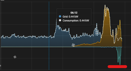

Looking better now, the red part is where i inverted them…
It will be great to have the option to use inverted values natively.
Most batteries report power this way. Positive is battery charging, and negative is battery discharging.
So creating a negative entity seems like a cumbersome workaround.
