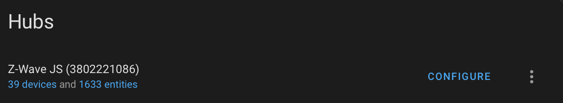

I noticed the “wrong” home_id is no longer available and both of the integrations I have point to the same home_id of my z-wave add-on. What is the right go-forward strategy here? Delete everything and start over?
Whatever happened recently to this integration is really frustrating.

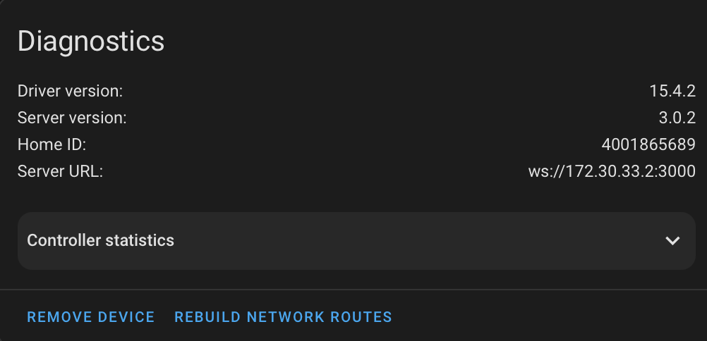

In Configure:

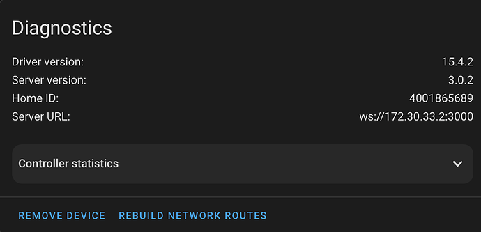

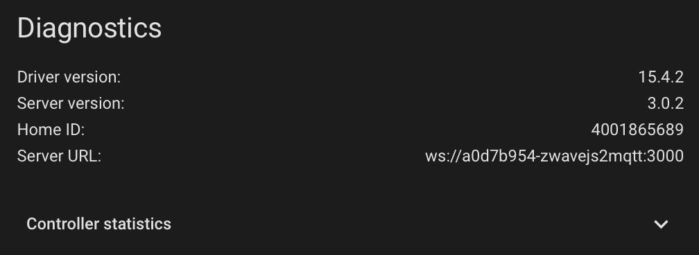

And the one that was using the prior home_id that was working until very recently:
In Configure:
In March, it was not like this - which is why I had named them with the home_id so I could keep track which I was enabling and disabling.

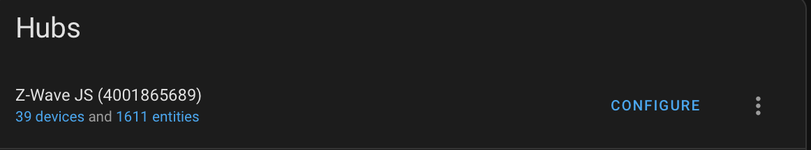

I have my HA setup in Proxmox, so I decided I could go scorched earth and restore a backup if need be. I think this may have resolved it for me (and with seemingly no impact).
  1. Deleted the integration with the IP address.
  2. Rebooted HA
  3. Deleted the integration with the DNS address.
  4. Rebooted HA
  5. All kinds of errors showed up because all of my z-wave devices did not exist. I ignored them. Oddly, my Hub-Z showed up in the Integrations page with a “Do you want to add this” label. I hit Ignore.
  6. I re-added the Z-Wave integration and input the DNS address of the add-on (ws://a0d7b954-zwavejs2mqtt:3000).
  7. All of my devices were rediscovered and took the areas from the add-on.
  8. Rebooted HA
Everything seems normal, the z-wave devices came back with the same device_id and entity_id entries that they had before, which I was worried would not be the case. Hopefully this is the last time I see an issue with the duplicate that triggered in February.
