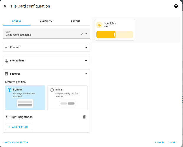

Guys, is this card with a slider a default one in home assistant? I can’t seem to find it when adding new cards. I guess it’s a custom one?
There is no such a thing - “default card”. Perhaps you meant “stock/standard card”.
This seems (could be) to be a Tile card with some added feature.
Yes, that’s what I meant. A stock card… So it’s basically a tile card with some customization.
No customization, just a feature added, which is an option.
Right now I use card called Mushroom, which looks nice but the slider is the button itself, so it’s not the best.
Could you point me in the right direction? How can I replicate that? I would love to have the exact same look for my light cards…
Choose the Tile card, then add a feature when editing your dashboard. This is all done via the UI, very similar to mushroom cards.
