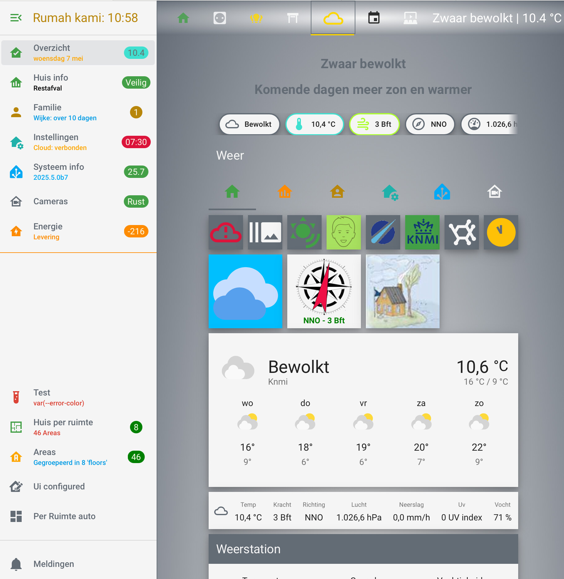

Just for clarification: app-header-text-color colours all tabs inc. the active one, whereas sl-color-neutral-600 colours all inactive tabs.
Or did Iget you wrong?
thanks and yes can confirm all of the hides are working again!
Seems ready for release :wink:
no, not wrong, I believe that is what I found yes. It makes you believe that app-header-text-color is for the active tab, but in fact is is the sl-color-neutral-600 overriding that everywhere, except for the active one…
and, since sl-color-neutral-600 also overrides any custom colorization one sets in card_mod with

so, I set a generic tab color with the appropriate theme variable app-header-text-color everywhere, and override that for the active tab with the current card-mod. Or override it based on conditions as shown above.
as you can see overriding the active tab uses the new --sl-color-primary-600, while overriding any other tab simply uses color:
Fwiw, I have been able to mitigate/incorporate all changes in theming variables and new designs with the great help of @elchininet and his wonderful plugins: Kiosk-mode (by @NemesisRE), Custom-sidebar, Keep-texts-in-tabs, and several serious changes in the card-mod theming.
That is, under the premise of those plugins to be updated to release soon, I have been running their dev versions for a few days.
If your interested, you can find my solutions at

Final result for now:
