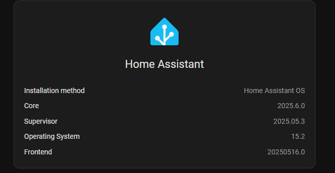

Today I ran the 2025.6.0 update, but it updated only the core component. Supervisor and Frontend stayed @ previeous version:
I’m I missing something?

Hmm, I dont think I understand - so, basically I wait (or make automation)? What about frontend, ther is no target for frontend update automation:

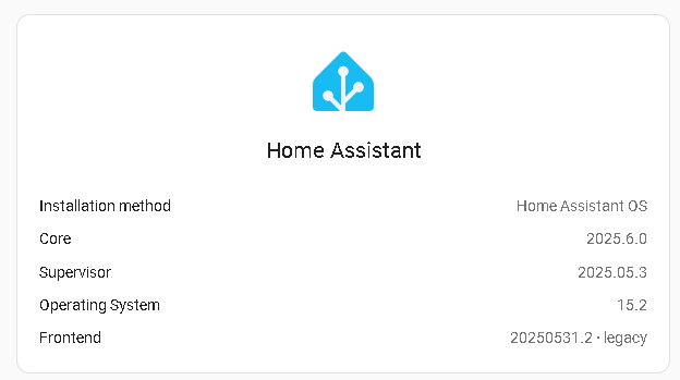

This is all the latest versions :

Hmm are you sure? They updated the UI, new sidebar editor, ovehauled pickers, new BT and zigbee networ visualizers… I’m getting none of that (also, version numbers (except core) are the same as before the upgrade…:man_shrugging:

Clear your browser cache. New front-end is probably not loaded.
Shit, that was it! Thank you, didn’t cross my mind!
