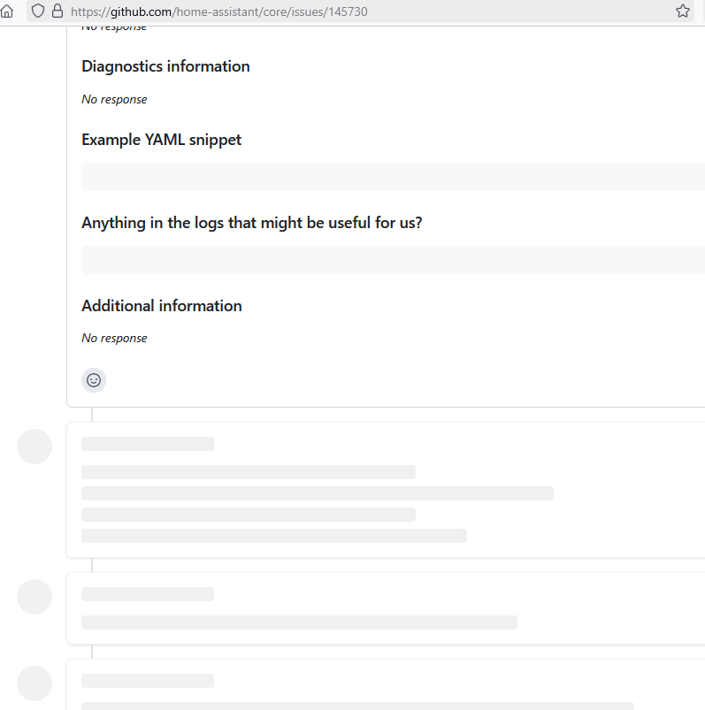

Seems the issue is locked., or another problem with Github
I think it’s a problem with github. Page is working for me.
This evening it was working. Added my logs to your issue.

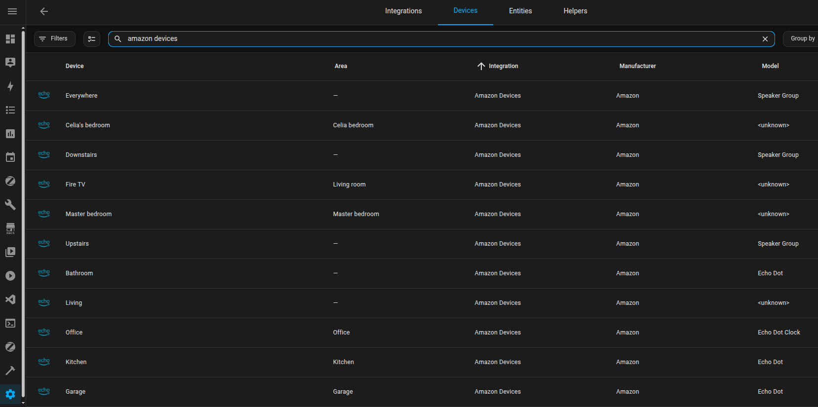

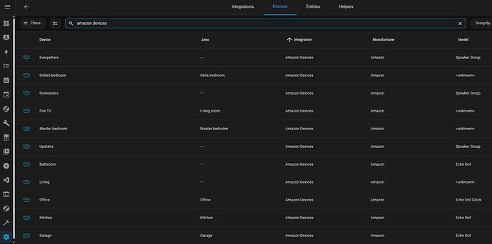

Just installed 2025.6 beta and integrated my 20 Amazon devices.

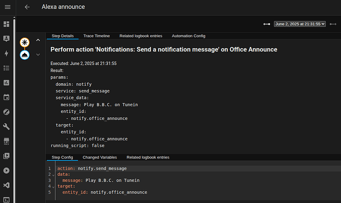

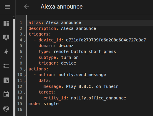

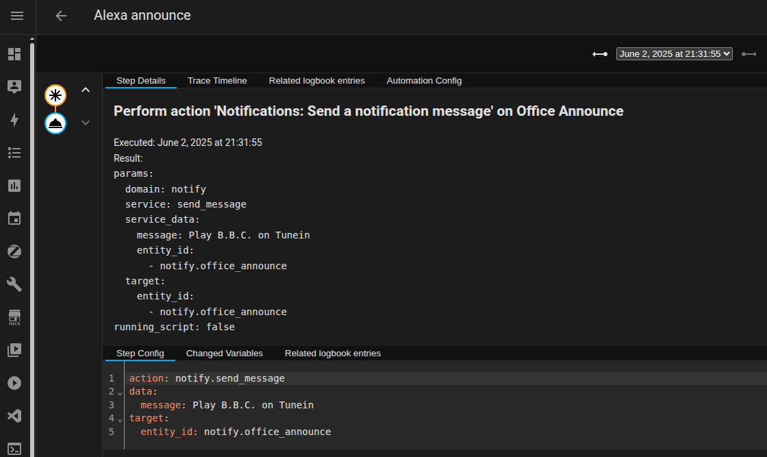

I have created an automation using the code given here but the speaker never says or plays anything :crying_cat_face:
My automation: it triggers, doesn’t fail but no sound comes out.
Did I miss something?

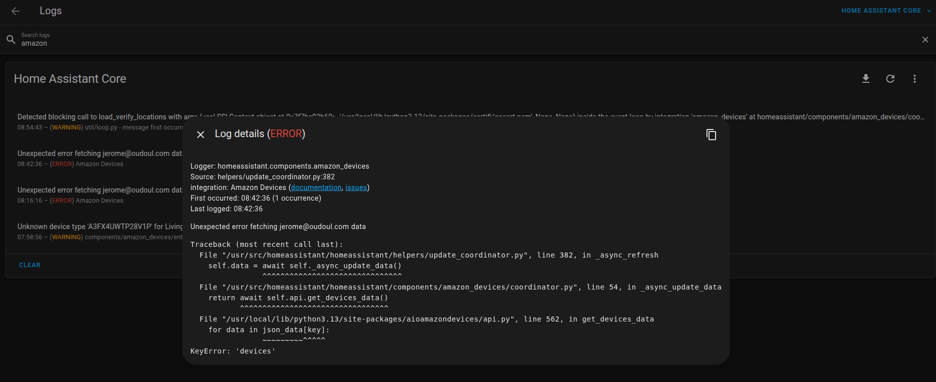

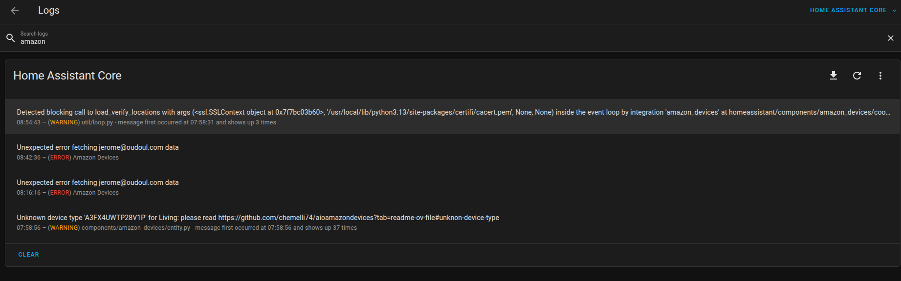

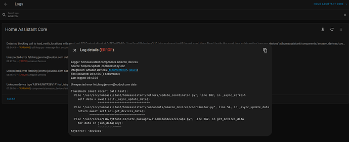

On /config/logs , if I filter out on the amazon keyword, I see a couple of errors (not popping specifically when I press my Ikea button to launch the automation) but I’m not sure what to make of them:
The last line is related to NON Echo Dot devices so fair enough since the integration only supports Dots.
Unexpected error fetching [email protected] data
Logger: homeassistant.components.amazon_devices
Source: helpers/update_coordinator.py:382
integration: Amazon Devices (documentation, issues)
First occurred: 08:42:36 (1 occurrence)
Last logged: 08:42:36
  File "/usr/src/homeassistant/homeassistant/helpers/update_coordinator.py", line 382, in _async_refresh
    self.data = await self._async_update_data()
  File "/usr/src/homeassistant/homeassistant/components/amazon_devices/coordinator.py", line 54, in _async_update_data
    return await self.api.get_devices_data()
  File "/usr/local/lib/python3.13/site-packages/aioamazondevices/api.py", line 562, in get_devices_data
    for data in json_data[key]:
KeyError: 'devices'
