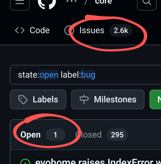

Where is the correct place to report bugs?
I reported on the link below, but there are more than 2500 bugs reported marked as “Open”.
Right there. Issues tagged with the beta version are added to the beta milestone.
Since only one of 2,600 reports is actually marked as a bug, it seems humanly impossible to manage the remaining 2599 :pensive:
The issue tracker is only for bugs. They are all bugs. Ignore the label bugs.

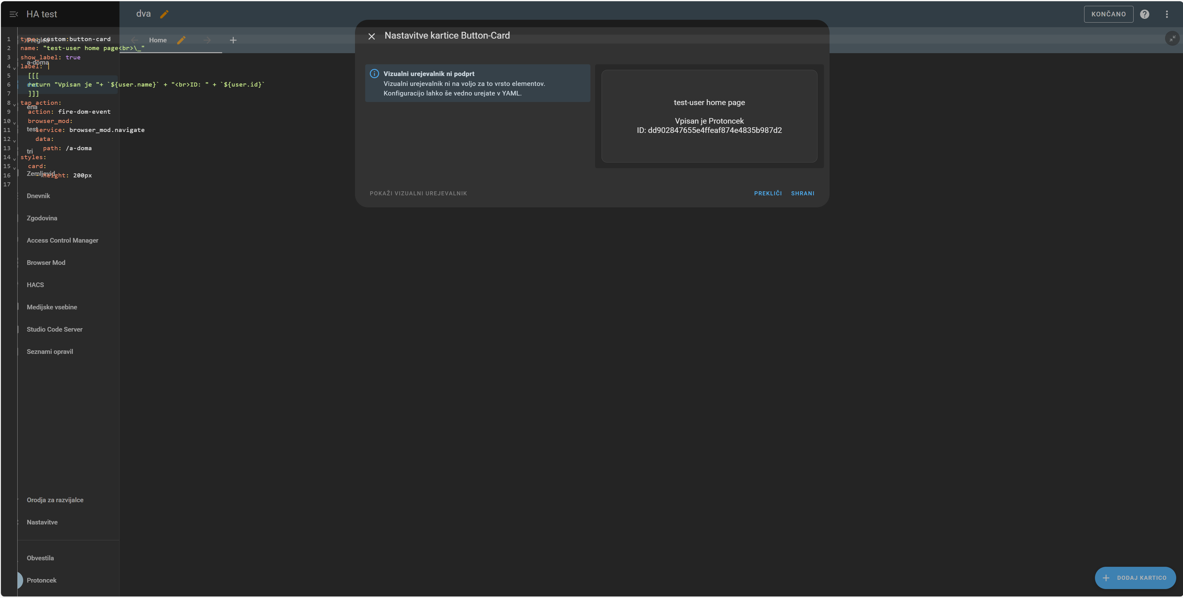

Did anyone noticed strange transparency issues when edit card in fullscreen (in beta4)? All is there at the same time: basic HA page, fullscreen editor and edited card. I can write in fullscreen, and changes are reflected in that smaller card window, but there’s no “save” or “cancel” button active. CTRL-S works, though.
HA restarted, HAOS restarted, cleared cache and hard-reloaded.
Yes, its happening to me too.
Yes, same here. Started in beta3, just updated to beta 4 and still happening.
Yes, getting this too, only in Dark Mode.
