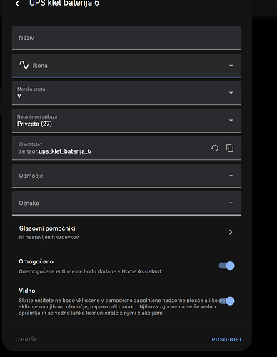

Now i do get one decimal precision, but, interestingly now all is kind of “odd”: default is still with zero decimals, it’s just that value is displayed with one decimal.

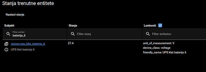

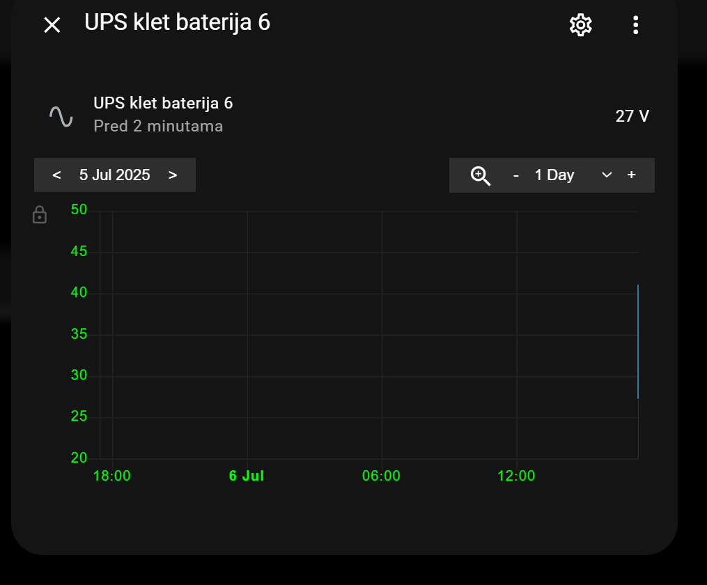

Just to eliminate old manual settings i created a new sensor (baterija_6) which shows:
which is correct, but this shows a different situation:
but exactly that can be a problem with big count of sensors… on each one i have to

The looks like its working right ? You’ve added 1 decimal place to the template and then changed to 0 decimal places in the UI ?

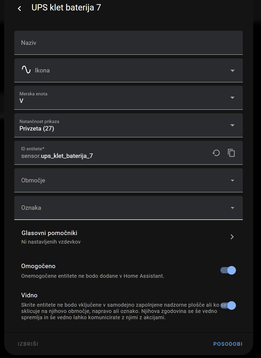

Change it to 1 decimal place in the UI

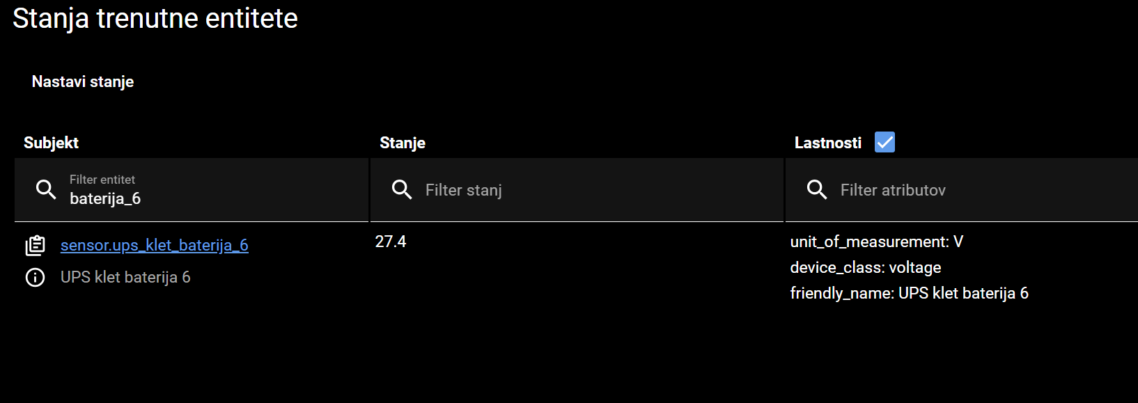

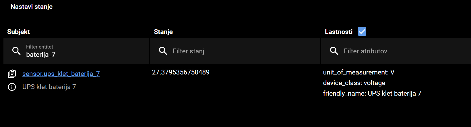

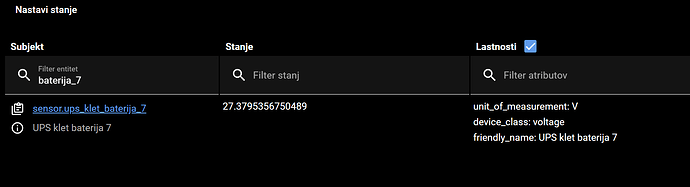

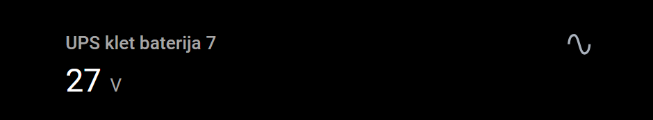

As you suggested i created another sensor, same as others, but without round(1). I restarted HA and this came up:
so again not correct. It’s not on two decimals, but zero.
that’s the same as i’d have 12 decimals. As i said i’d like to avoid to do that on hundreds of sensors one-by-one and solve it the way it should be - at the source.
You’re still looking at the under the hood value…
Look at the state in the UI.

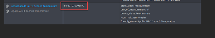

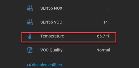

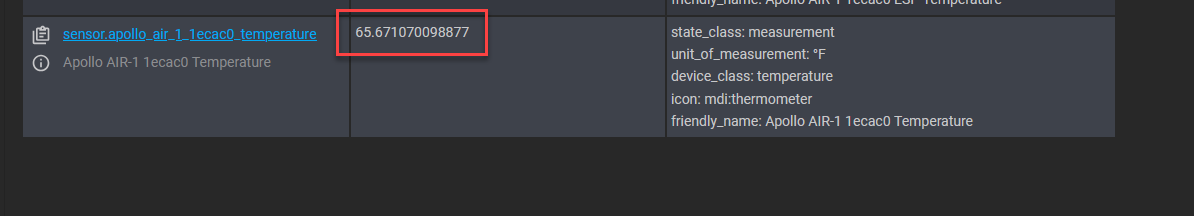

I.e. here’s the under the hood for temperature:
But in the UI, it defaults to 1 sig fig without altering anything.
same there, this is shown without any changes made in UI:
Ok, then change it to whatever you want. It appears as if the default for V device_class is 0 sig figs.
Indeed, I just created a template sensor and as soon as I added the voltage device class it went to 0 decimal places, but you can change it in the UI to 1
Correct! If i remove device_class and leave empty then it reverts to 12 decimals. I did have to change aaaal my batteries from zero to 1 decimal not long ago, yes.
