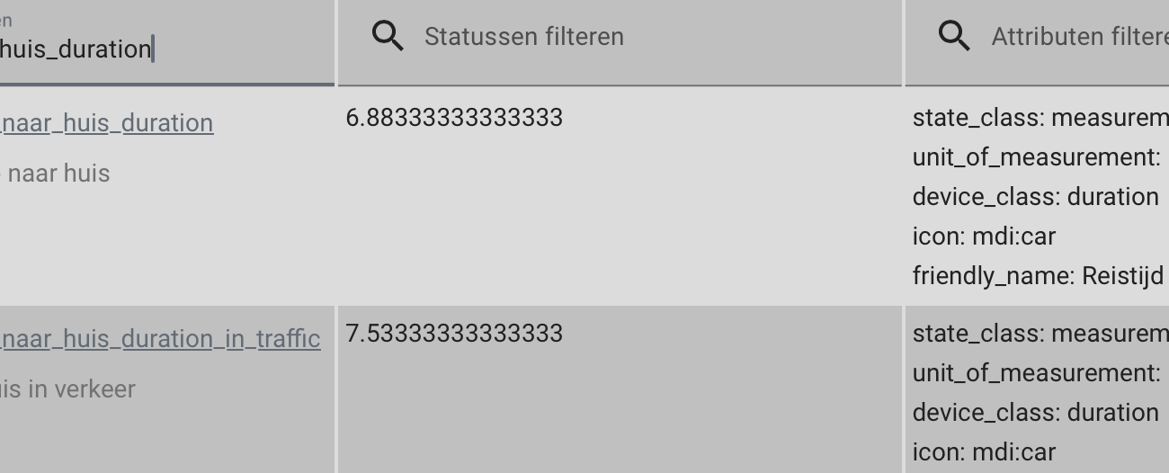

it from the here travel time integration
and I dont round these values either
        message: >-
          <person> is op {{states('sensor.thuis_<person>_distance')}} km van huis,
          en is over {{states('sensor.<person>_naar_huis_duration')}} minuten thuis!
so yeah, probably should add that now to prevent Murphy again
For sure, because .4333333333 minutes is 26 seconds. The repeating numbers will happen on all the following seconds in a minute:
1, 2, 4, 5, 7, 8, 10, 11, 13, 14, 16, 17, 19, 20, 22, 23, 25, 26, 28, 29, 31, 32, 34, 35, 37, 38, 40, 41, 43, 44, 46, 47, 49, 50, 52, 53, 55, 56, 58, 59
If you want to see for yourself:
{%- for i in range(61) %}
{{ i }}: {{ i / 60 }}
{%- endfor %}
Haha cool.
Yes. Will do. Maybe travel time could limit that in the integration ? What is the point in this case …
Duration sensors can be hours, minutes, or seconds. While it may make sense to handle this on minutes, with hours it would drastically skew the result.
of course.
these are in minutes though, and I dont think the integration offers different units, so it could take that into consideration.
Ill just |int those for the notifications. they’re way off anyway, so clean up the notification and the Intercom :wink:

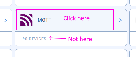

One request: when writing something like " Integration page gets an overhaul" could you please provide something that helps the reader find what you mean by ā€œintegration pageā€. I went to what I thought to be the integration page (Settings/Devices & services/Integrations, with which Google AI agreed) and it still looks the same as before this release (despite a browser refresh). Now I don’t know if I have the right page or I am using a screen too small for the new look or what. I just can’t find a page that looks anything like the example in the release notes. I am not asking for the release notes to be more detailed, just for writers to be sensitive that terminology that may be obvious to them may not be to all readers. Often, a single hyperlink is all that is needed.
More generally, one of the challenges getting up to speed with a system that is so well developed over a relatively long period is the evolving terminology. I think I have nearly mastered integration, platform, component, device, sensor, entity etc. and can handle their inconsistent use in historic writings, but can get stuck on ā€œsimpleā€ things like above!
Click on an integration on that page that has more than one device.
In my very subjective point of few, only one term in HA has many meanings - ā€œbadgeā€.
Thanks @tom_l. I tried all my multiple device integrations: MQTT, Apple iCloud, Shelly, ZHA and I can’t see anything new. Tried a big screen as well as phone. I should read the detailed notes now. (But I still think my point about terminology is valid.)
