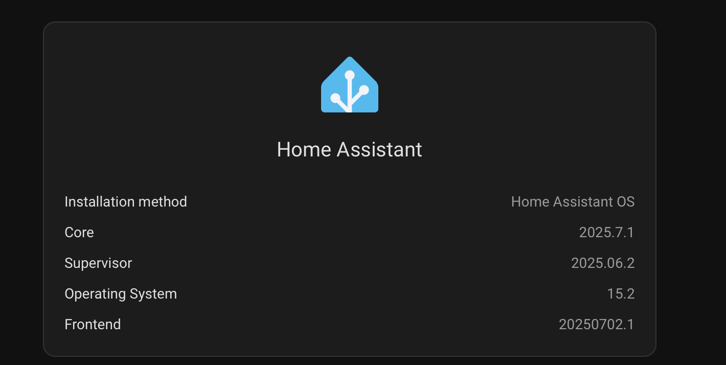

I have HAOS and running 2025.7.1:
Somehow my instance doesn’t notice there is an update (to .2 and to .3). I already manually hit Check for updates but nothing happens, any ideas?

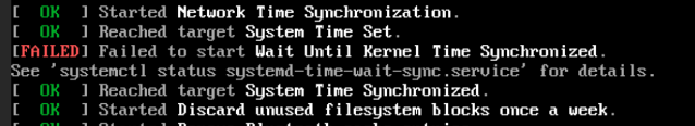

not sure if this is new, never noticed before, but check:

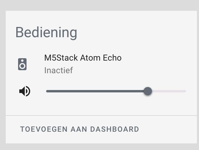

in the ESPHome device dashboard for the Atom echo.
there is no way to pull up the more-info on the volume slider. Clicking the icon now is an active toggle for the volume, and the slider sets the volume, as it should.
The toggle seems to be new, and, well, a UI issue…

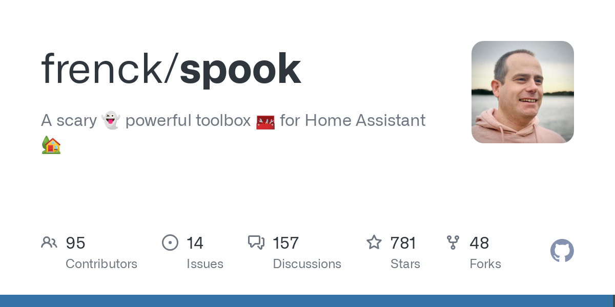

I use the spook integration for that, I was so fed up in things brake without noticing.
Tbh I think spook should be a default feature in ha.
