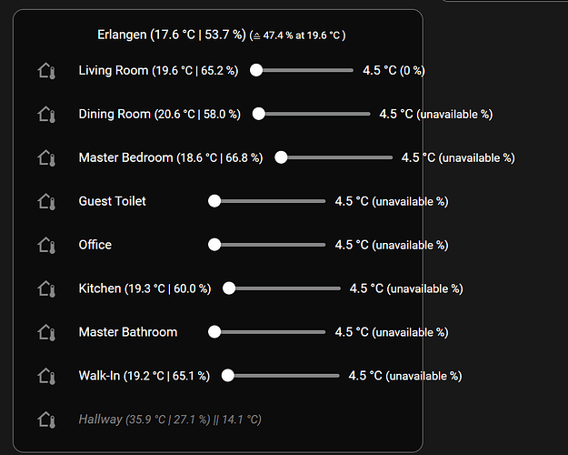

I switched all my dashboards to the new Sections style but I now have a card that is not properly rendered. Neither in browser nor Companion App.
Does anybody know how I can force rendering inside the card?

Is this a custom card? Or one where card-mod is used?
Still breaks in 2025.10 unfortunately. I’m restoring back to 2025.9.3 now!
more of an auto-entities question as this has no relation to the 2025.9 release
also, your auto-entities card is configured in an unconventional way, as you list the fixed entities under the filter option.
considering those cards are within the border of the section, the actual auto-entities in the quote above seem to be the issue, what happens when you dont use the card-mod on them
(please post an answer in the auto-entities topic)
