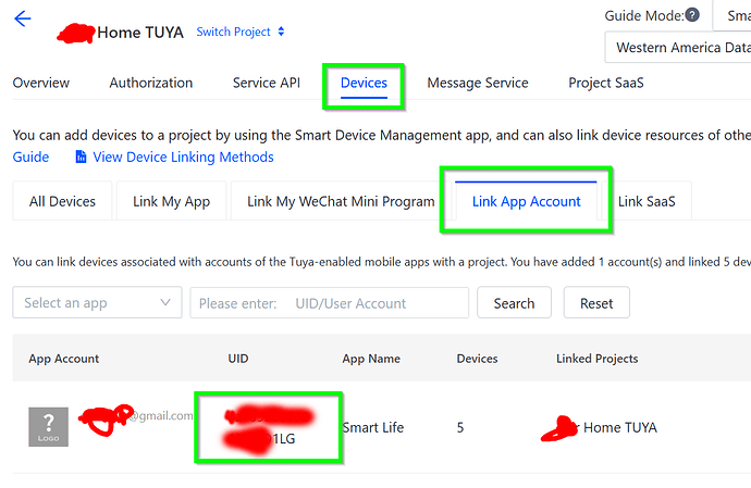

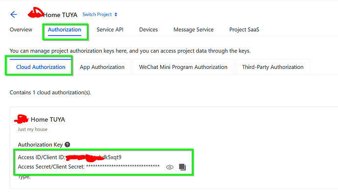

I attempted to get this working some time ago, so I already had a Tuya developer account. There are walkthroughs on getting that set up and others that show you how to use a rooted android phone to get your local device keys. I’m going to assume you already have an account and have failed to get the integration working (like me!) and just need the push in the right direction.

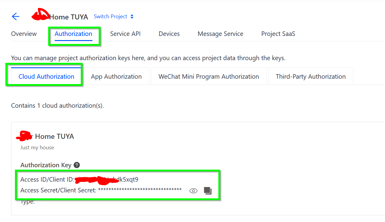

So You go to Tuya Smart Developer Center and log in, if you haven’t already. Then open the project. First we need to grab your ClientID and Client Secret
And your UserID
I would recommend you put these somewhere for future reference like 1Password or similar.

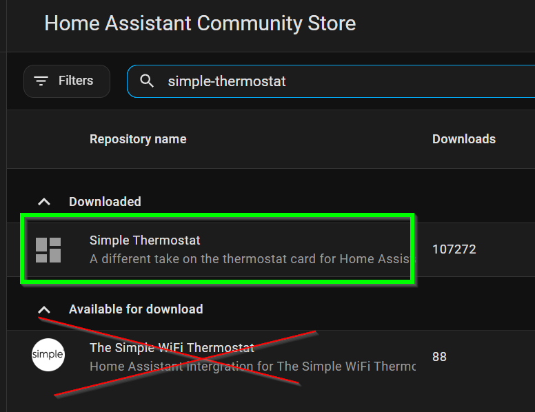

OK, now it’s time to install TuyaLocal - BUT!!! Don’t install the one that’s already in HACS - that one doesn’t work. You need to install this integration instead: https://github.com/xZetsubou/hass-localtuya. I liked using the install links in the documentation, made it a breeze!

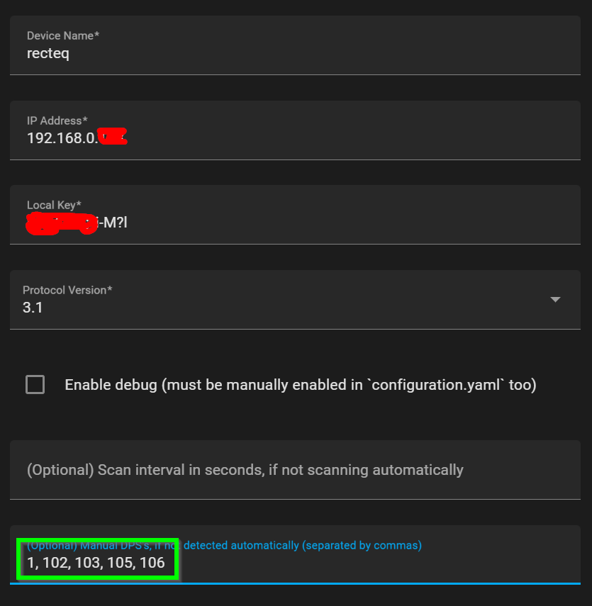

OK, so you have it installed - time to configure it. Adding the hub using your saved credentials is easy enough, where I ran into problems was when I went to actually configure the smoker. The DPS were not being recognized, I had to put commas in between them: 1, 102, 103, 105, 106. I also found that protocol 3.1 works and 3.3 did not for my particular smoker, so be ready to play around with the protocol too if you have issues.
I had to do this a few times so here is my cheat sheet of IDs and entity names. If you’re “leveraging” my setup, you may want the same entity IDs:

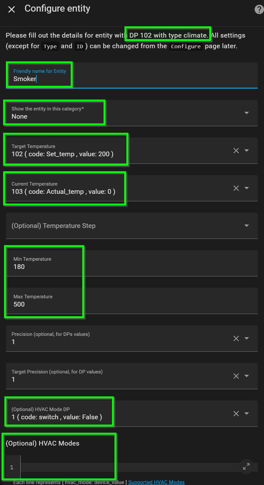

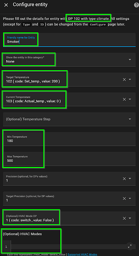

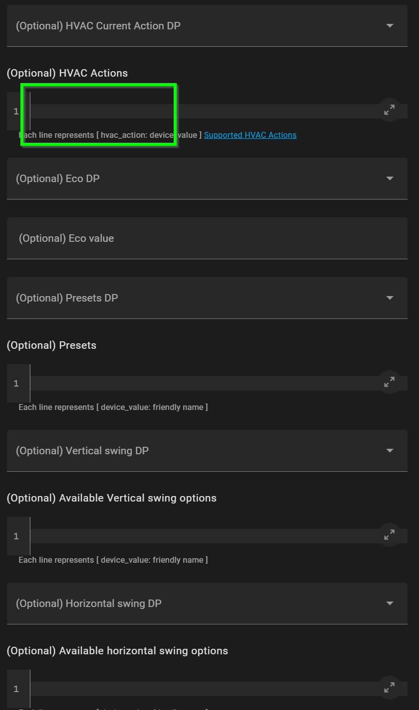

You need to configure the temperature control FIRST. This will let you use the DPs as part of the control. In my case, 102 is the target, 103 is current, and 1 turns the smoker on and off. Here are all the settings I changed

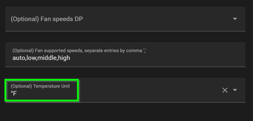

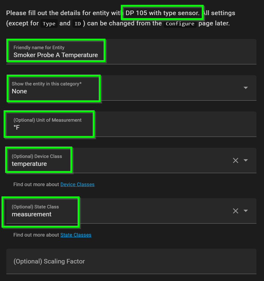

FUN FACT! If you do not set the “(Optional) Temperature Unit” to °F - it’s going to assume the numbers are Celsius and convert it into Fahrenheit and suddenly it shows your grill set to 600°F - ask me how I know.

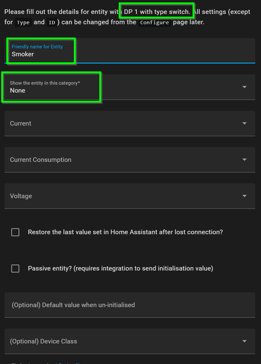

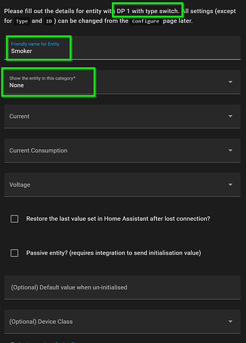

Alright, now let’s go back and set up the smoker on/off button (1)

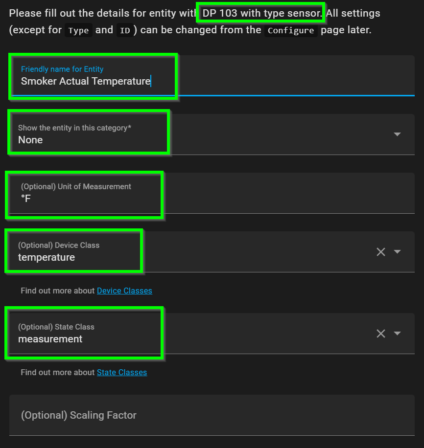

Now we want a sensor for the current temp (103)
Let’s do Probe A (105)

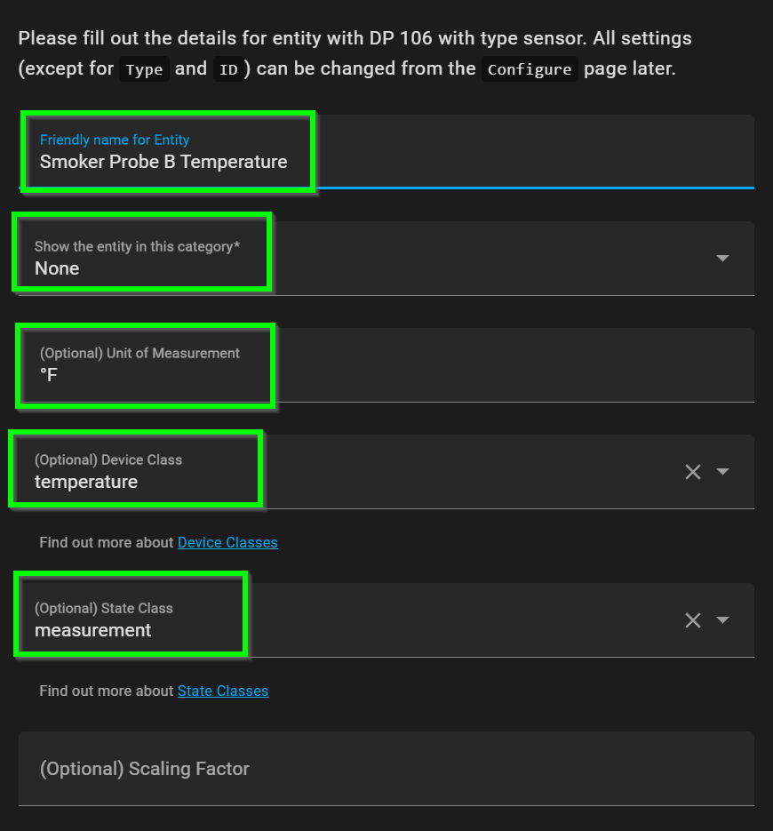

And Probe B (106)

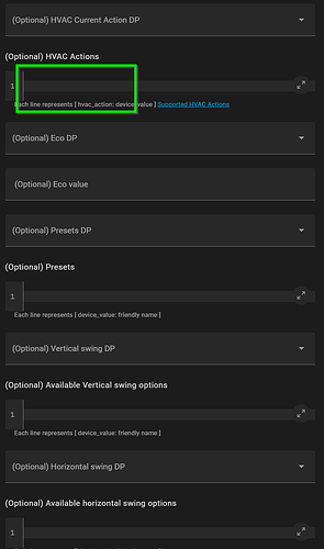

At least with the RT-700 Bull, you can totally stop here, or if you like, you can configure the other entries. I’m not currently using them on anything but it’s up to you.

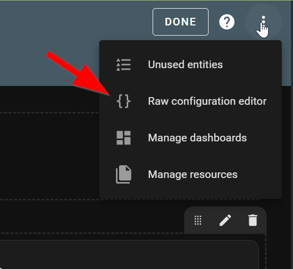

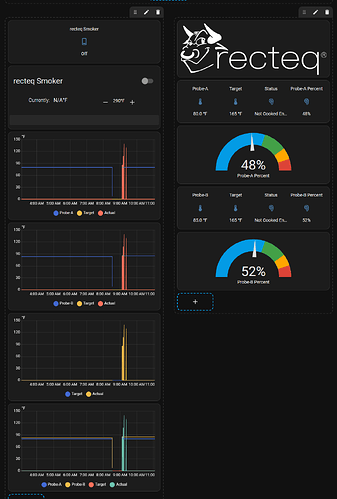

OK, that was a lot. Let’s make a dashboard. I used a lot of the details (again) from this post
But the setup is different in Home Assistant now and I couldn’t just copy/paste it, so I got to do “New dashboard from scratch.” Once that is made, you can choose to either use the following information to make the dashboard using the GUI (like I did), or you can try pasting it into the “{}raw configuration editor” and see if it works:

You’ll notice that a lot of the entries show and hide based on what the smoker is doing. If the smoker is off, it only shows the main switch, then it shows different graphs and such depending on if the probe is plugged in or not.

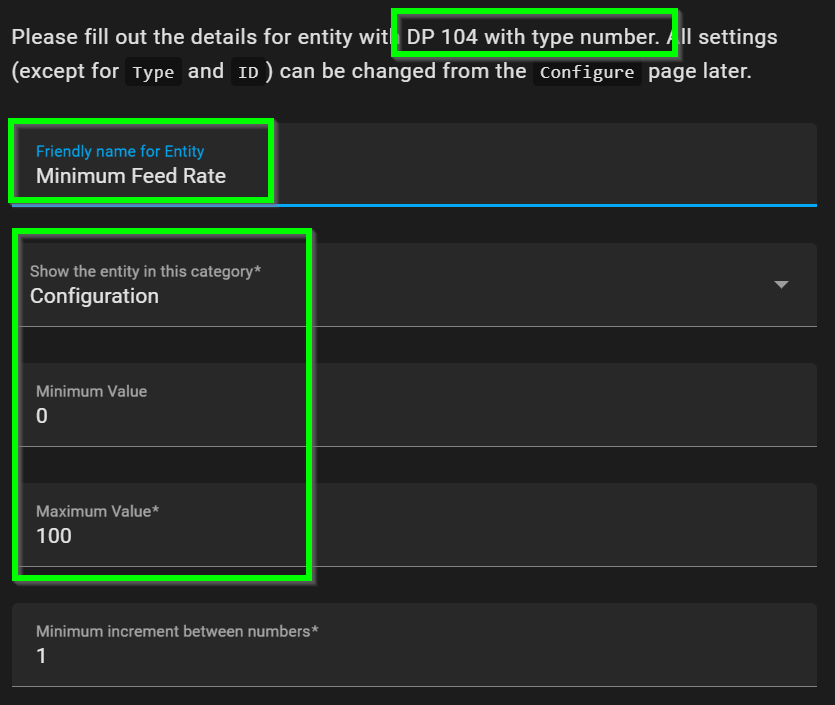

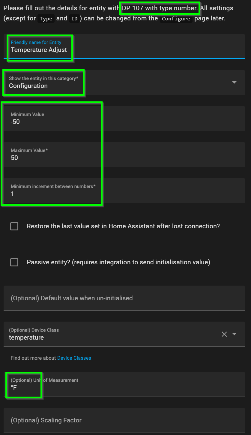

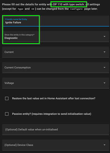

Thanks for this guide! I’m very close to getting my new Flagship 1600 connected, but stuck adding the device in the LocalTuya integration. I keep getting this error: “Connection to device succeeded but no datapoints could be found.” I’ve tried a bunch of combinations for the datapoints and protocols, but nothing seems to work. Anything else I can try? Thanks again!
RESOLVED:
I think this was due to having the Tuya app still open on my phone. I was able to pull down the Datapoints for the Flagship 1600 and finally able to connect on Protocol 3.4
switch - 1
Set Point - 101
Actual Temp - 102
Probe A Temp - 103
Probe B Temp - 104
Min Feed Rate - 105
Temp adjust - 106
Power failure - 107
Ignite Failure - 108
RTD Failure - 109
Paste this string into manual DPS: 1,101,102,103,104,105,106,107,108,109
