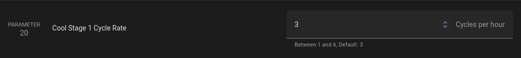

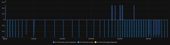

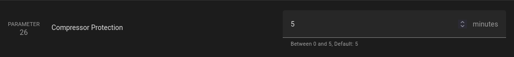

I did get a couple of used Honeywell T6 Z-Wave thermostats and installed one the other day for my AC. Been working OK so far.
It does seem to cycle a lot but I think I can adjust the cycle rate and compressor protection settings
Many thermostats work to maintain temp at +- xx degrees of set temperature
T6 setting determines min/max on cycles to maintain temp(or something similar).I though it ran too often when I first got it but over time realized it worked more effectively.
Yeah I was thinking this, too. I trust Honeywell more than Nest for good compressor and HVAC practices.
