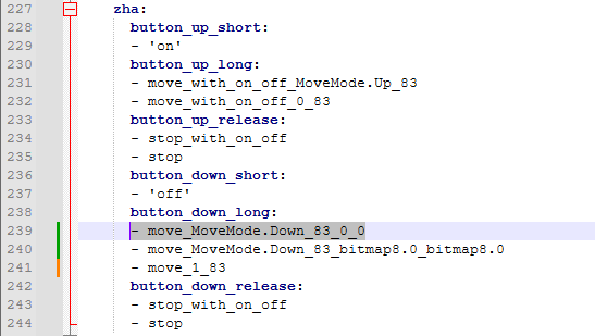

I think I found a bug with the Ikea E1743 On/Off switch controller Blueprint.
I was not able to dim my lights with a long press through the ZHA integration, while all the other commands work.
With my E1743 button (might be HW or FW version dependant), a long down press returns the following deserialized value :
move_MoveMode.Down_83_0_0
This should be added as an entry in the list starting line 239 of the Blueprint.
FYI, here is the ZHA event when I long press the ON/OFF button:
And the corrected Blueprint:
I believe I fixed this in my fork.
