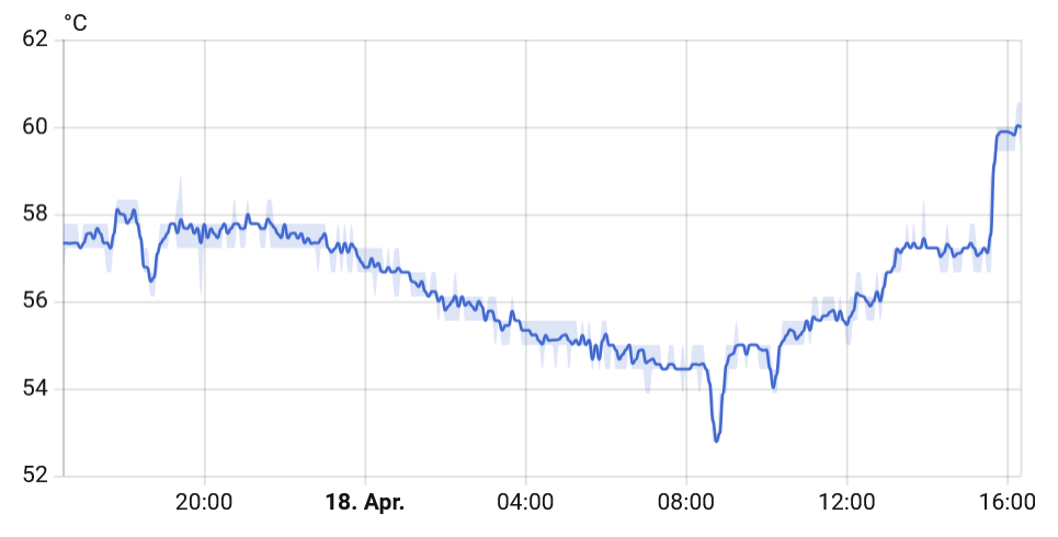

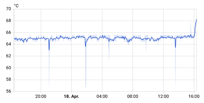

I use this sensor on a few of my ESPs:
sensor:
  - platform: internal_temperature
    name: "Internal Temperature"
    update_interval: 60s
    entity_category: diagnostic
    disabled_by_default: false
    unit_of_measurement: °C
    state_class: measurement
    device_class: temperature
And after updating from 2026.3.3 to 2026.4.0 the temperature increased quite a bit, roughly +3 °C compared with the moments from right before the update:
65 to 68° C
(placed inside)
57 to 60° C
(placed outside)
3 deg increase of die temp is completely insignificant except for power consumption. Yours is just relaxing at 60 'C. Esp runs happily at 100 'C. And the temp sensing is not calibrated, it can be 10 deg off…
