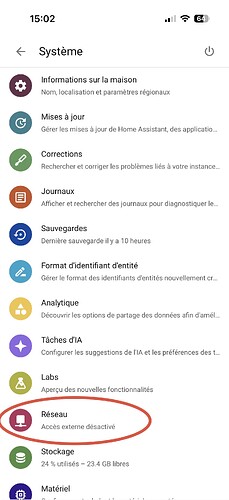

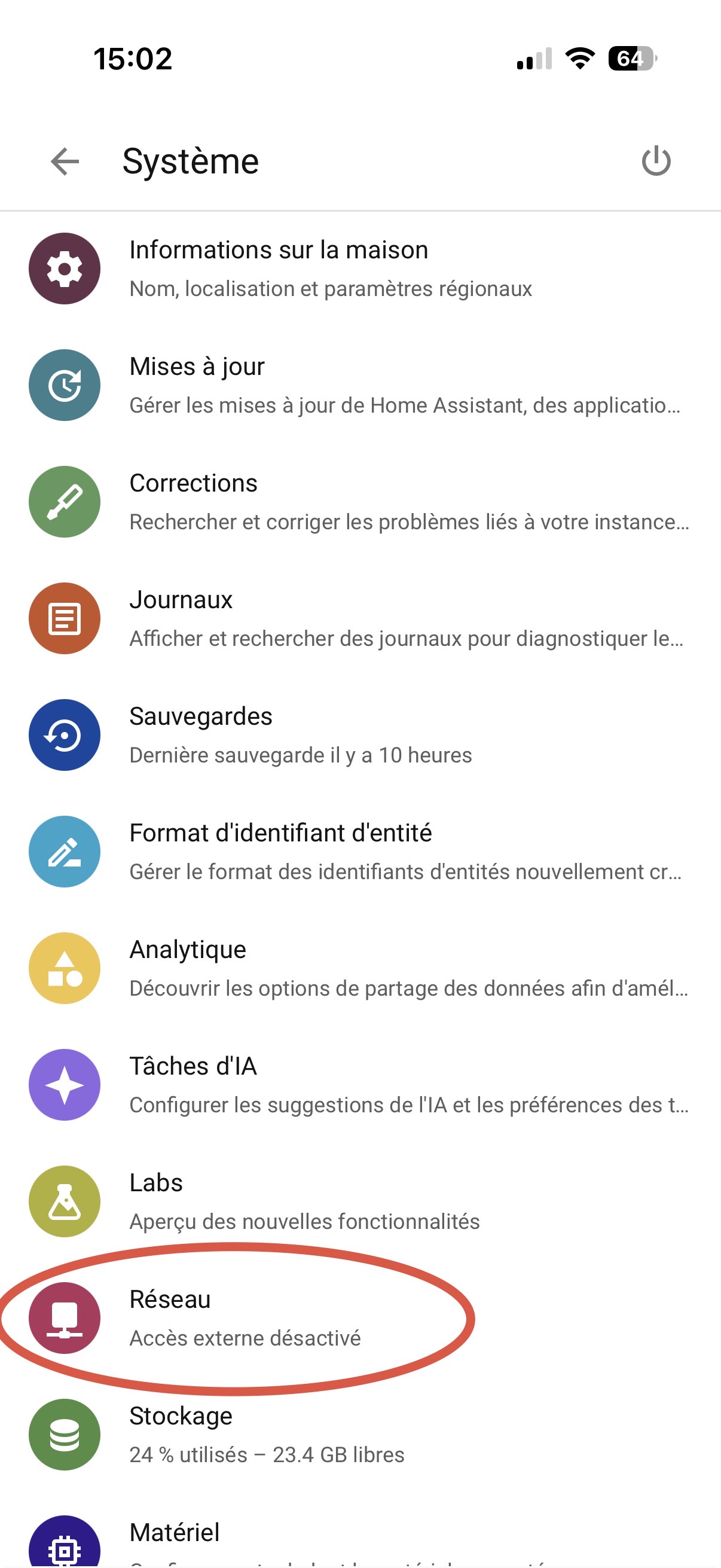

Another question.
On the menu, Remote access appears as disabled while it is working.
How is the appearance of this message determined? Did I omit something in my configuration?
I answer myself.
It seems that this message appears when the external URL is not filled in. The URL indicated in the Companion App is not taken into account in the display of this warning message
