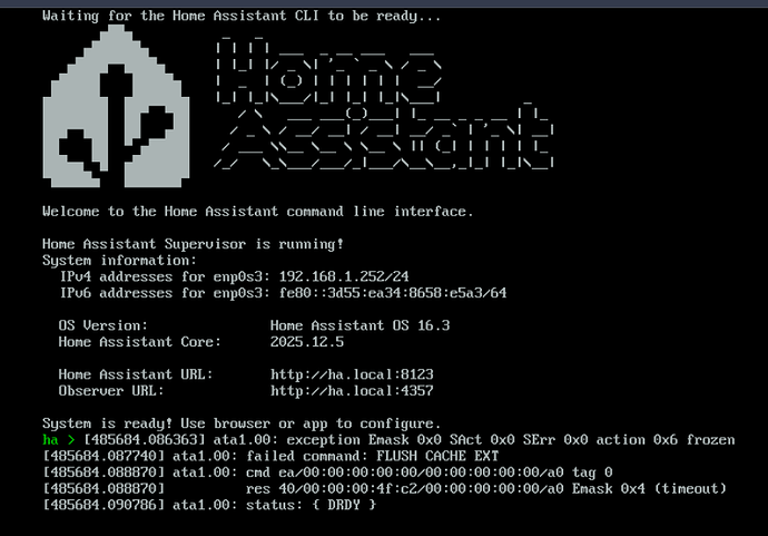

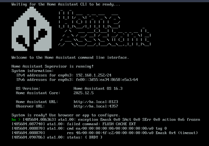

System came back after update but was really really really slow and the console shows this error:
I had to restart some module manually and all seems to work fine
 just slow.
Searching the web I found the same kind of error messages & slowness with previous updates but couldn’t find the root cause.
which storage are you using ? SD, SSD or ?

Your disk is not responding or timing out. What storage are you on? If it isn’t soldered or included in the compute module, (mentally) start preparing to replace it.
Could be similar, not sure about his “conclusions”
