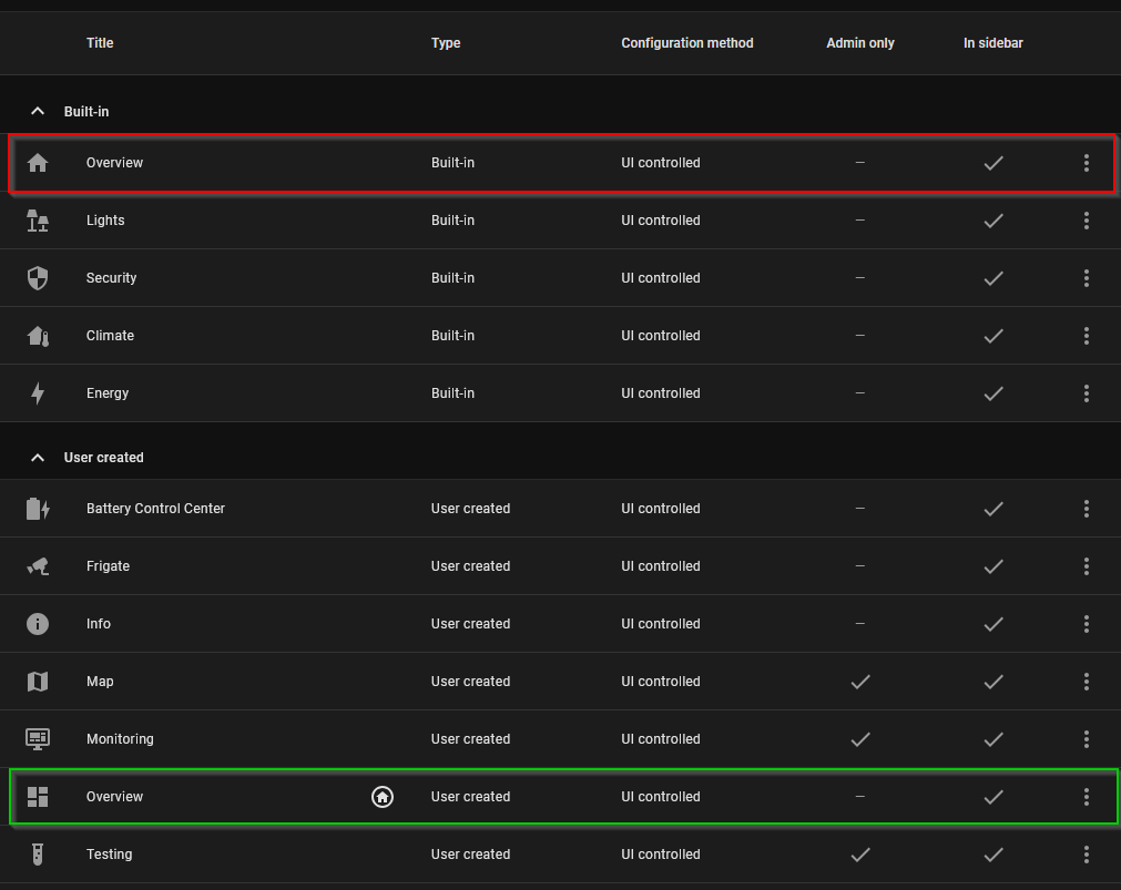

Ok. So I probably missed something. I read that this new “Home” dashboard would be the default dashboard for new users. I am not a new user and I have set a custom user-created dashboard as the default dashboard for all users. But everytime I open the start URL of HA or I open the HA app on my phone, it shows me this new “Home” page that I DO NOT have configured as default.
Are you using bookmarks? You have to update your bookmarks. Otherwise you didn’t set the default dashboard properly.
No bookmarks. I just open the clean base HA URL and a clean launch of the HA app. It always opens the new Home page. My user created default dash is also called “Overview” so maybe that is why it defaults to the system built-in “Overview” dashboard.
Anyway. I fixed it by setting overriding the default dashboard in the user settings. But I don’t like that I have to do this for all my users.
You don’t have to do that, whatever you’re doing in the dashboards menu is not properly setting the default dashboard.

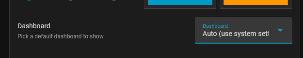

Your user should be set to: Auto (use system setting) and it will use the default dashboard specified in settings → dashboards.

I had to set this to my user-created Overview dashboard to force it to NOT use the new system Overview dashboard.
However! Now that I set it back to “Auto (use system settings)” it continues to use my user-created Overview dashboard. So it seems fixed now.
I had the default dashboard set via the dashboard page (the 3 points > Set as default). I tried selecting something as as default and then setting it back to my Overview dashboard, but that did not fix it.
But selecting something else as the default dashboard in my USER settings and setting it back to auto, fixed it. Also fixed for other users without having them do the same thing.
