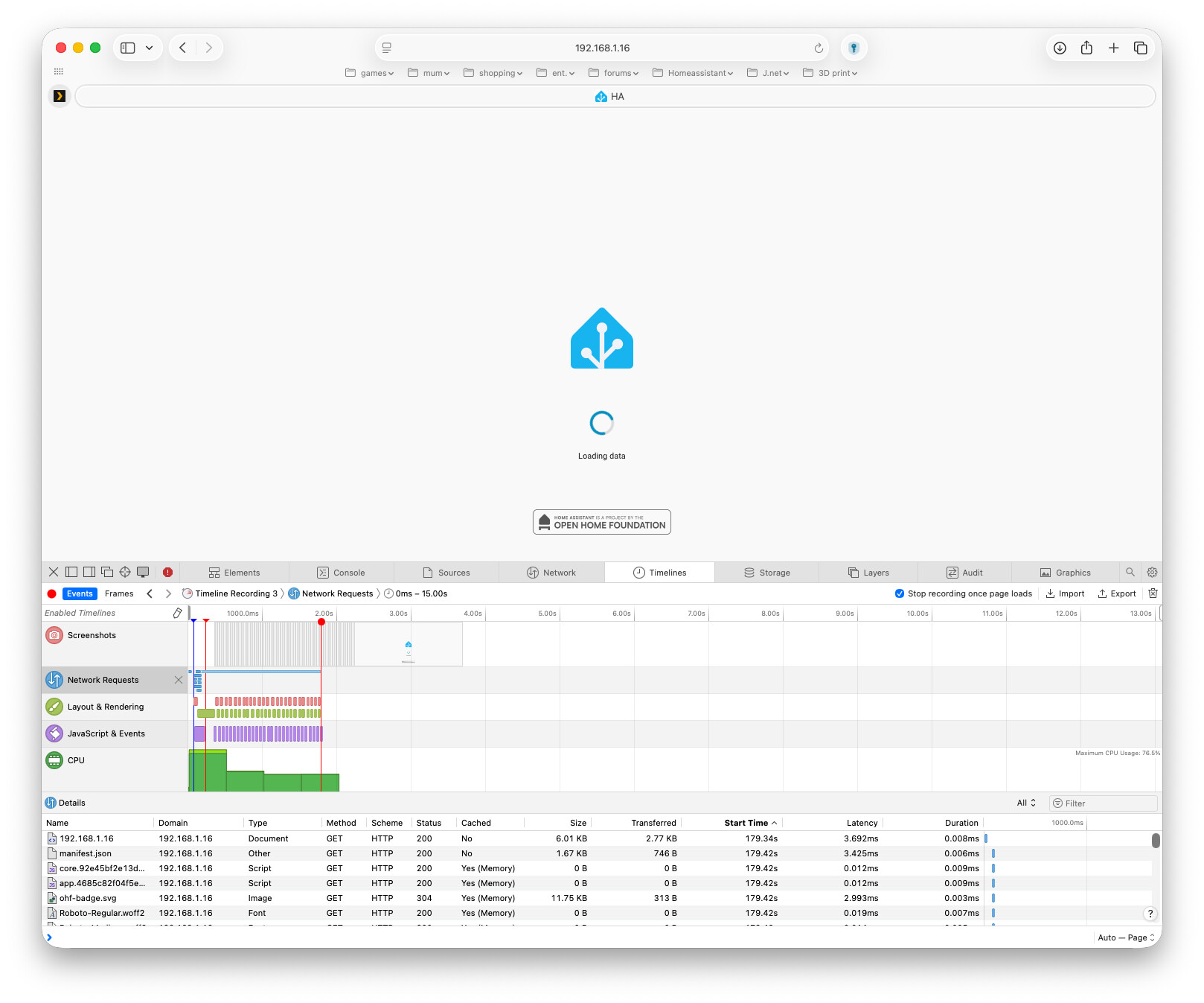

This is a screenshot of the web inspector timeline when it hangs but I’m not sure how to analyse it (this was taken after maybe 60s of hanging:

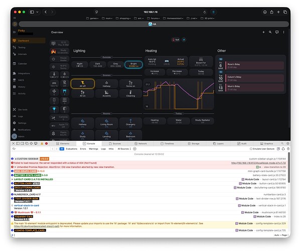

This is after I call the website twice within ~1sec (it loads instantly on the send attempt):

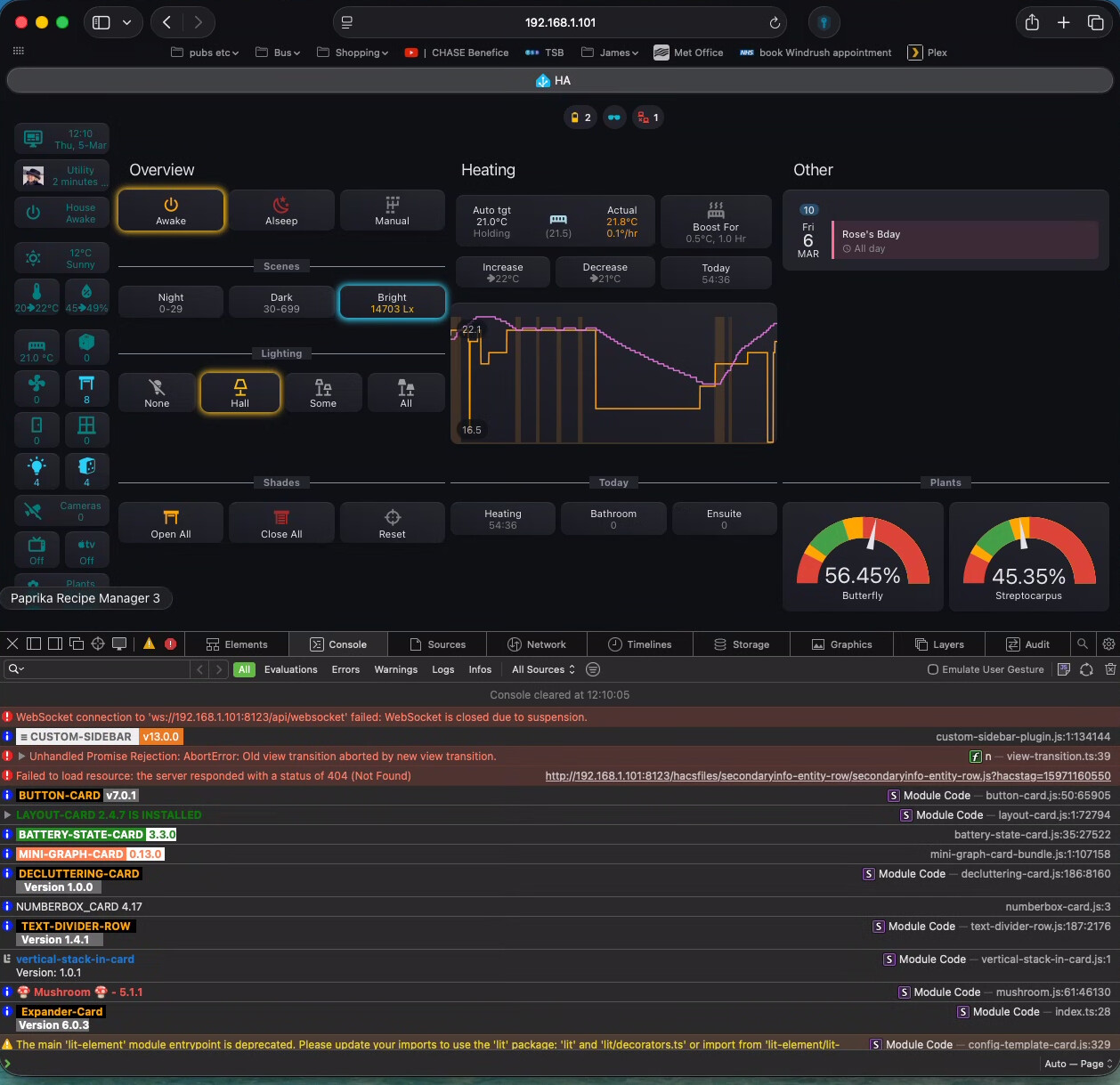

This is the 'OK" Safari instantly loading a different instance of HA (but still 2026.3.0)
