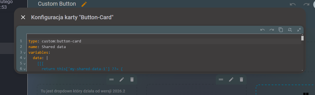

I don’t have a Discord account, so I’ll just post it here: fullscreen mode in the code editor doesn’t work, making the popup smaller, as shown in the screenshot below. I cleared the cache and restarted.
I brought it up on discord, will let you know how it develops. It actually works fine in dev tools template editor and in automation creation… it’s just cards.
Edit: Opened and issue

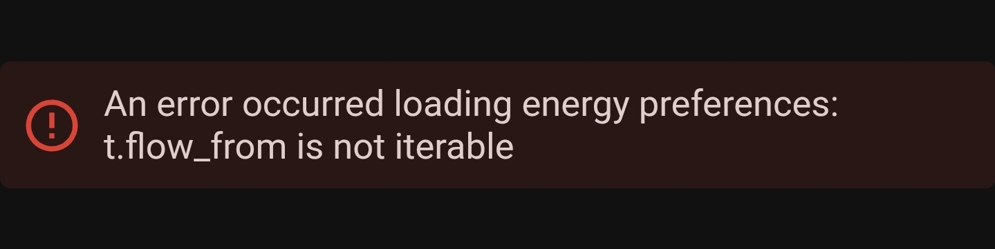

Anyone else got this error in the energy dashboard?
It´s a black screen with only this error.
I get those from time to time after an update on odd screens, reloading takes care of it for me.
Fixedin b2
I just updated to b2, didn´t change. Reloading or restarting either. No logs about this in core.
You should open an issue in HA’s frontend repository for this then.
you mean this
