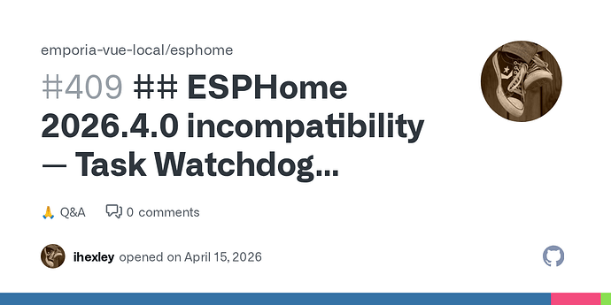

Yes, both on Wifi… but I’m going to attach ethernet to the dead one and see if I can find signs of life. Over on GitHub there are others reporting the same situation and, at the moment, appearances that they might be bricked since one person can’t get anything via serial either. I’m about to try as well.
Yeah mine is wifi too. But I don’t assign a static IP in the config like you do. I assign a fixed IP in Unifi on my UCG-Max. Don’t think that really matters with our issue though.
Following the source referenced at the top of my yaml from where I got it, there is also an open discussion topic regarding this where the user switched to arduino framework AND ESPHome 2026.3.3 which appears to have fixed it (or at least a workaround for now)

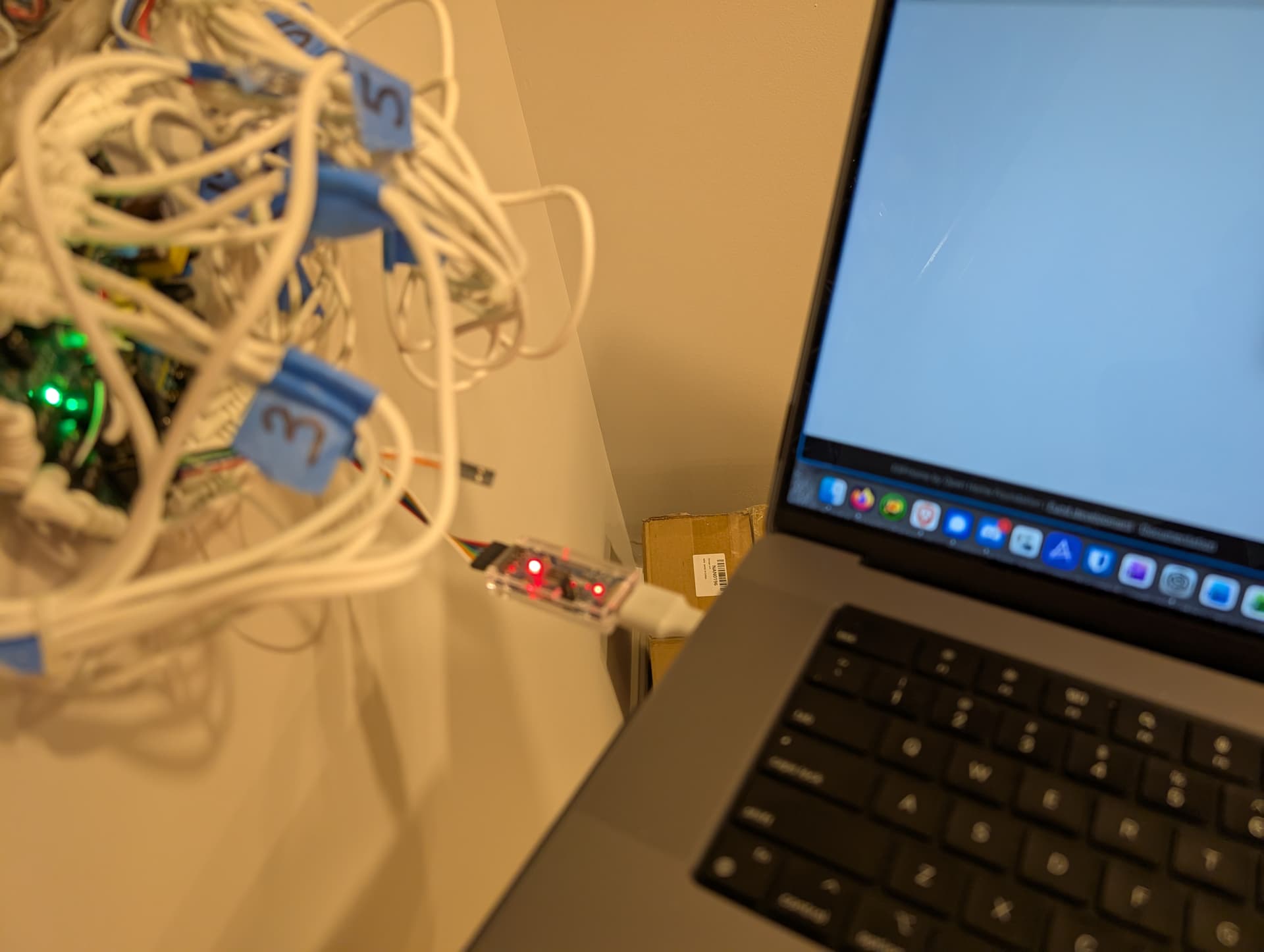

Super janky repair, didn’t want to disconnect all the wires.
  • Unplugged main power
  • Recompiled in esphome (for manual file download)
  • Connected serial adapter, grounded the boot pin
  • Plugged in USB to laptop
  • Flashed bin from esphome
