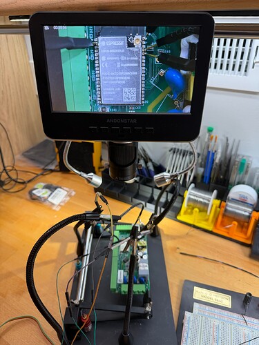

I’m back in business now after removing the bricked one from the panel, bringing it to the workbench and flashing my 2026.3.3 firmware via UART.
I had to bust out my original janky pogo pin monstrosity that I created to originally flash the Vue3 units when I first bought them. I made rigid but bendable rods out of 12 gauge home wire, taped Dupont wires to them, shoved pogo pins in one end and can then attach additional Dupont wires to route to my USB serial interface, etc. Pop it under the microscope with some magnetic bendy “magic hands” holding stuff in place. I combined GND and IO0’s pogo pins through a breadboard so I could just momentarily poke IO0 with the end of it as I plugged in the USB serial interface. Voila - esptool sees everything just fine.
Works like a charm. :slight_smile: I should make something more elegant or invest in a proper pogo holder, but the goal is not to have to do this routinely.

I did flash through serial, requiring opening my electrical panel, disconnecting all the CTs an power to the Vue, opening the VUE case and using my BDM frame and probes to tap the right pads.
