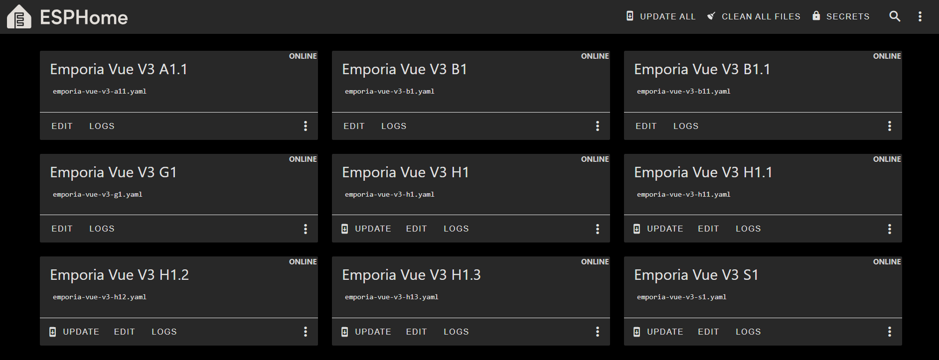

I don’t normally curse… but today… WTF… :rage: I’ve been spoiled the past couple of years… every time I upgraded ESPHome, it’s been flawless… I used to upgrade almost every update, then I started only upgrading every 2-3 months. I read the release notes, I upgrade and look to see it comes online… I have 9 of these Emporia Vue 3’s… Most are using Ethernet, 1 is using WiFi. I upgraded the first 4 before I realized something was wrong…
The first 4 are upgraded to 2026.04 (A1.1, B1, B1.1, G1), the last 5 are on 2026.02… NOTICE they are showing ONLINE

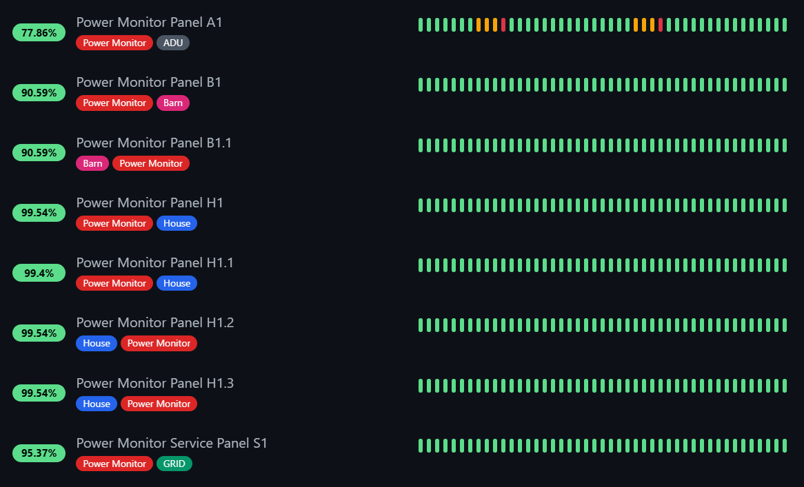

In my case, the devices are pingable on the network… I use Uptime Kuma to monitor them…
You’ll notice, Panel A1 (A1.1) does go offline… Panel B1 and B1.1 were also going offline due to:
Network Loops & Storm Control - Critical - STP State Flapping
NOTE: I’m unsure if the STP State Flapping is related to the firmware issue… REASON: Also last night my UniFi network was updated (throw 2 changes into the mix), so I was unsure if the issue was with the switches, so I disabled the ports and re-enabled them, apparently this caused the default VLAN to be set and the devices got a DHCP address in VLAN1, then I reconfigured the switch ports to IoT VLAN and then they got their reserved IP on IoT VLAN… this is when I started seeing the STP blocking… I think this was related to me trying to reconfigure/fix the ports on the switch…
As a test, I disabled RSTP + Loop Protection and also put these two devices on a dumb switch, then plugged that into the IoT VLAN that B1 was originally on. Thus, you can see via Uptime Kuma that the devices seem to be reliably on the network.

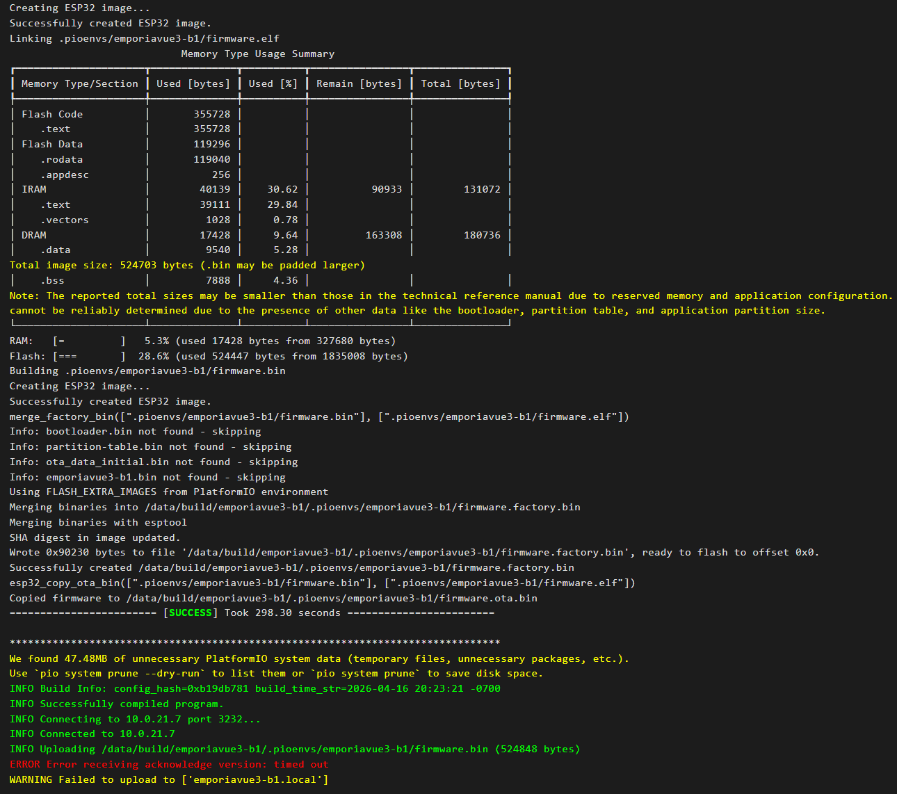

Restored ESPHome to 2026.02, attempting to reflash via OTA is unsuccessful…
Interestingly, it does seem able to connect to the IP and port… :thinking:

Yup, I have the exact same issue. I even tried timing sending the most basic YAML directly to the Vue 3 with ESPHome 2026.3.3 and it still fails with the same error you received.
At one point I got it to say ā€œuploadingā€, but ultimately it failed with the same error. It must be crashing so fast it has no way to send the OTA update
At this point I have wasted too much time and will just end up flashing with serial, as I only have 1 Vue 3.
