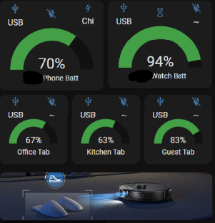

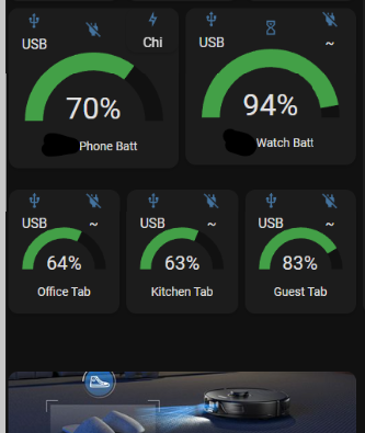

After the update I did a page refresh and all our dashboards have extra spaces that weren’t there before in places where there are conditional cards.
Before : 2026.3.4
After : 2026.4.2
Initially I thought it was card_mod, but the conditional gap between the tablet batteries and the Roborock button doesn’t use any css.
