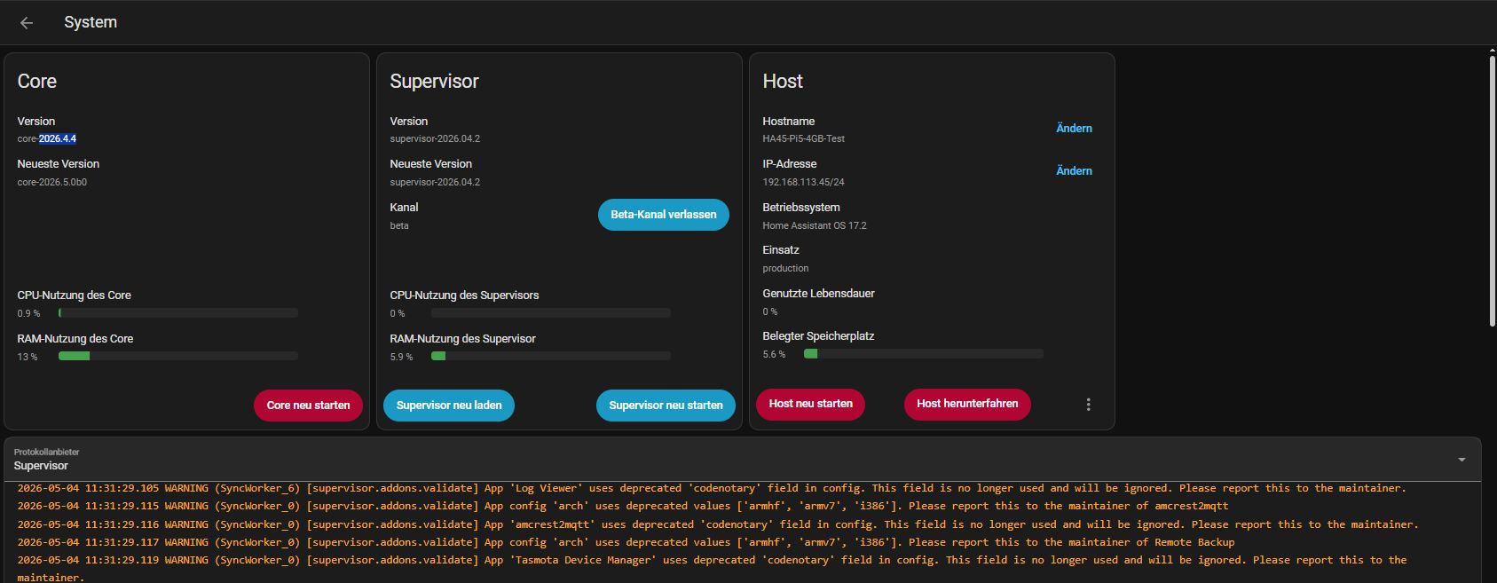

It looks like the /hassio/system has finally been removed.
That’s a shame. It was particularly useful on test systems for getting an overview of the installed HA components and quickly restarting them.
I hope it comes back because there isn’t really an alternative yet.
(Screenshot from 2026.4.4)

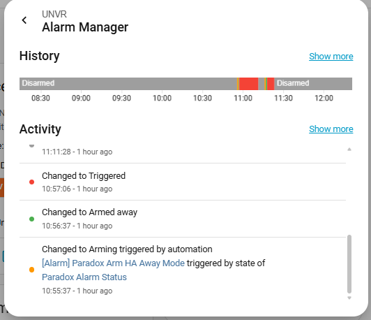

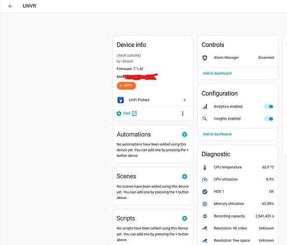

I just discovered another random thing happening since updating to this beta…
My Unifi Protect integration is arming based on the status of my home assistant alarm. There are no automations or scripts setup to do this so I don’t understand how this is happening.
There is however a logbook entry suggesting an automation caused it, but that automation doesn’t not specify Unifi Protect at all.

I’ve hunted through everything on my system and there is no logical cause for this. Any ideas? It only started after updating to the 2026.5.0b1 beta so the only thing that I can think of is that it’s related to the recent updates to this Integration which now includes the Alarm Manager entity.
EDIT: logged an issue.

It sounds like Unifi Protect just got a new alarm entity right? So wouldn’t it be expected that it would get picked up by all in your action? (I didn’t actually know you could use all so thanks for that tip!)
That’s exactly what’s happening. The all is targeting all alarm control panels.

Right! That code is many years old and I totally missed it. :man_facepalming:
Explain in discord, I understand what is happening now.
