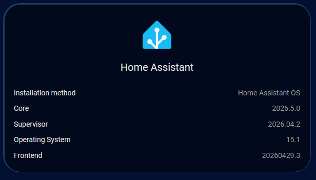

:thinking: For some reason the 15.2 OS version is flagged as skipped but the newer versions are ignored (won't show) and I don't have buttons to unskip it.
I would like to access Advanced SSH & Web Terminal to force updating but some of the UI links aren't working, /config/app/a0d7b954_ssh/info throws "Error while loading page app."
Edit: I managed to trick it into updating to OS 17.3 from the Developer tools part of the UI, still having the UI pages errors.
I will probably manage to update core to 2026.5.1 the same way so the UI will be fixed.
Edit2: So after emptying my browser cache all works perfectly in the UI, I should have started with that yesterday...
