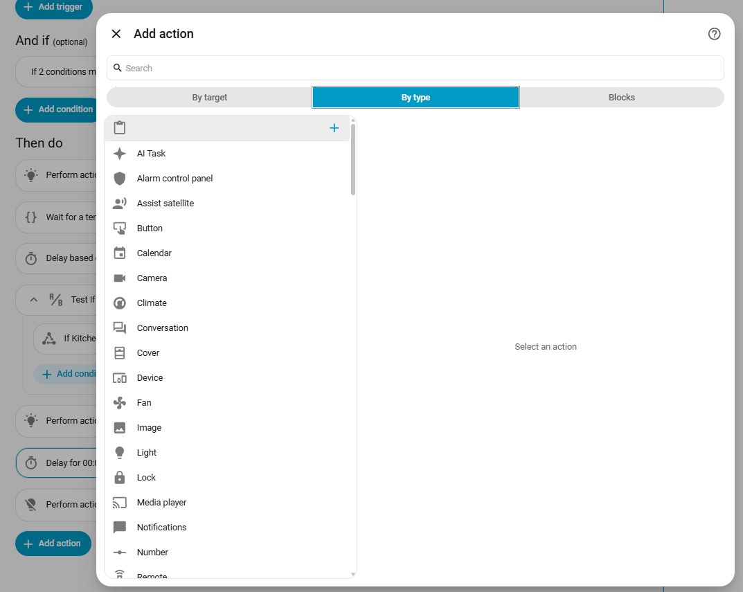

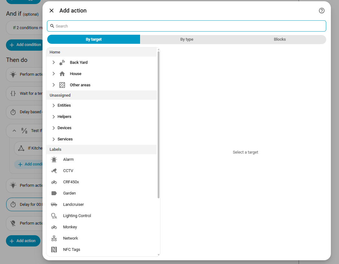

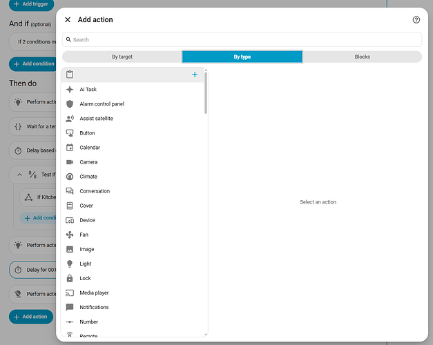

Here's another perfect example of such an inconvenience:
I selected 'copy' for an action within the Automation Editor UI, then select '+ add action' and I'm greeted with this popup:
... which requires an extra click to open the 'by type' tab of the popup in oder to get to the 'paste' option. ALso, just noticing this now in the 2026.6.0b0 beta version that there is no longer the word 'paste', only the icon.... bug?
