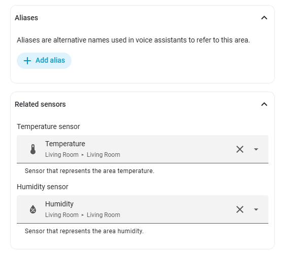

So there is a place where you can tell an area which sensors accurately represent the area values, for those two classes! It's just not used for this; I think they only apply to voice assistant questions.
So that's my ask. Give us the ability to, for each area and per device class, specify a particular sensor (or sensors) that accurately represent the area state. If it's not overridden, use the existing method: it'll work fine on small and simple systems. But adding this rescues the feature for complex-system use by people, non-admin users, who aren't fully intimate with their details, and that's worth doing.

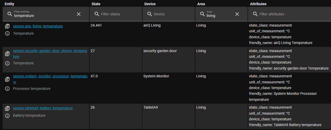

I haven't installed the latest version yet, but are all temperature sensors in an area considered for these new triggers? That seems very bad design if I look for instance at my living room sensors; airQ_living a proper temperature device, a device temperature of the door sensor, a temperature of the nuc running HA and a temperature of the tablet on the wall.
Averaged that would never be correct. I was expecting this trigger to use the proper set area temperature sensor as reported on the new Home-overview page and as pointed out above.

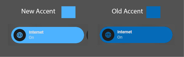

Something I noticed immediately, the primary accent color changed and it reduces legibility/accessibily with add-on cards that utilize white text over the new accent color. See below using bubble-card, same problem with other mods.

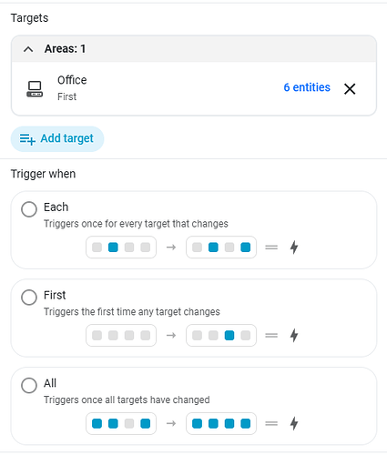

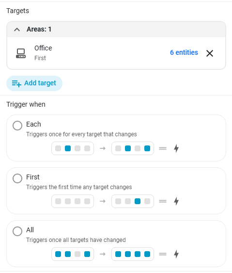

It's not averaging; it seems to have an option which lets you pick whether the trigger fires when each, the first of, or all of the sensors in the area meets the condition:

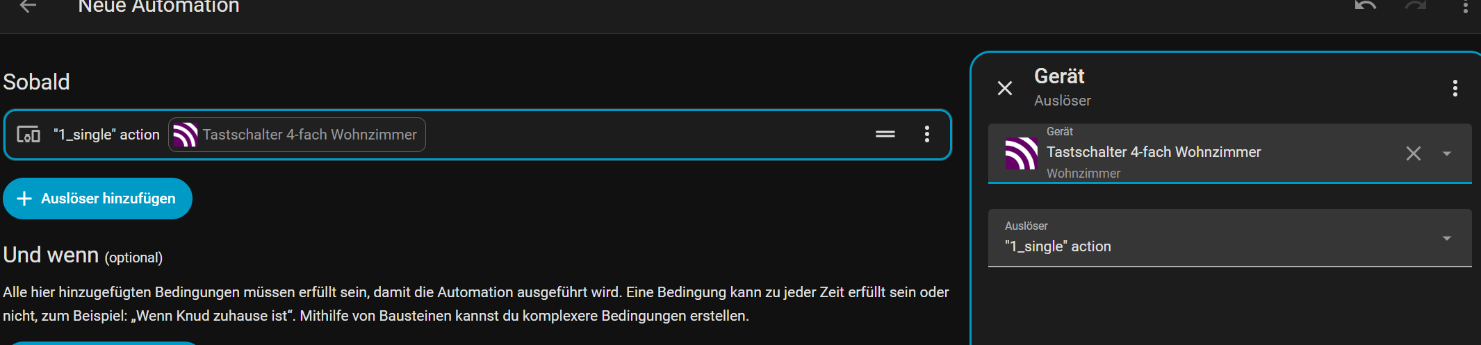

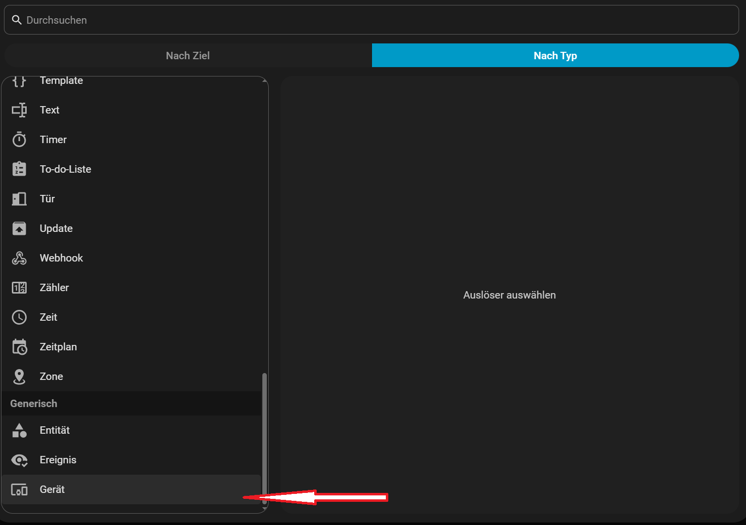

Please Help. How do I do this in the new GUI? I have a new button I need to set up but the only options on the device in the new GUI is about the battery? It is a three-button Zigbee device. The screen shot is from an existing automation.
To add the trigger by target will fail, you will only get the battery entities. Add the trigger by type (see screenshot) and scroll to "device" (screenshot). There you will find it:
Vielen Dank
I had trouble finding this option. This new GUI is not better for some things!
