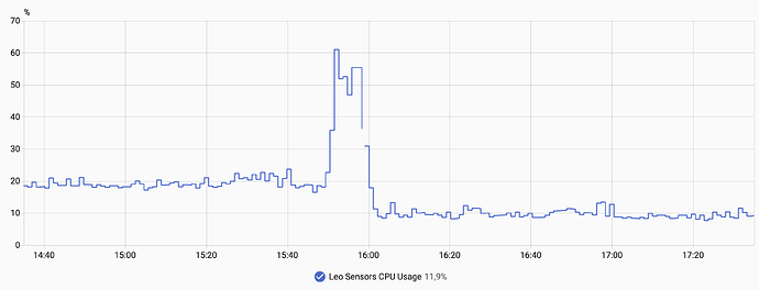

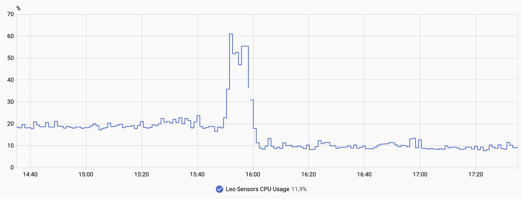

At a previous Core update from 2026.5.4 => 2026.6.1 my RPi4 CPU Usage doubled from 10 to 20%. Interesting enough, at the recent update from 2026.7.1 => 2026.7.2 this was fixed and I returned from 20 to 10% CPU Usage again :slight_smile:
No idea which specific repair fixed did this :thinking: but big thanks anyway! :+1:

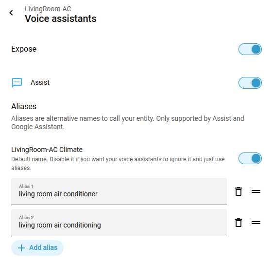

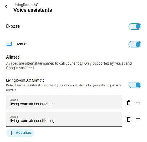

Anybody else having problems with voice Assist aliases since 2026.7? My aliases for my air conditioners stopped working when I upgraded.
Exposed to Assist, was working fine in 2026.6 and earlier:
But now:

I’m having the exact same issue. I initially thought it might’ve been just MelCloud but just tried aliasing my Tuya AC and it gives the same error, might be a climate entity issue.
