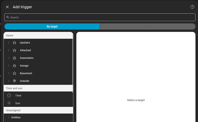

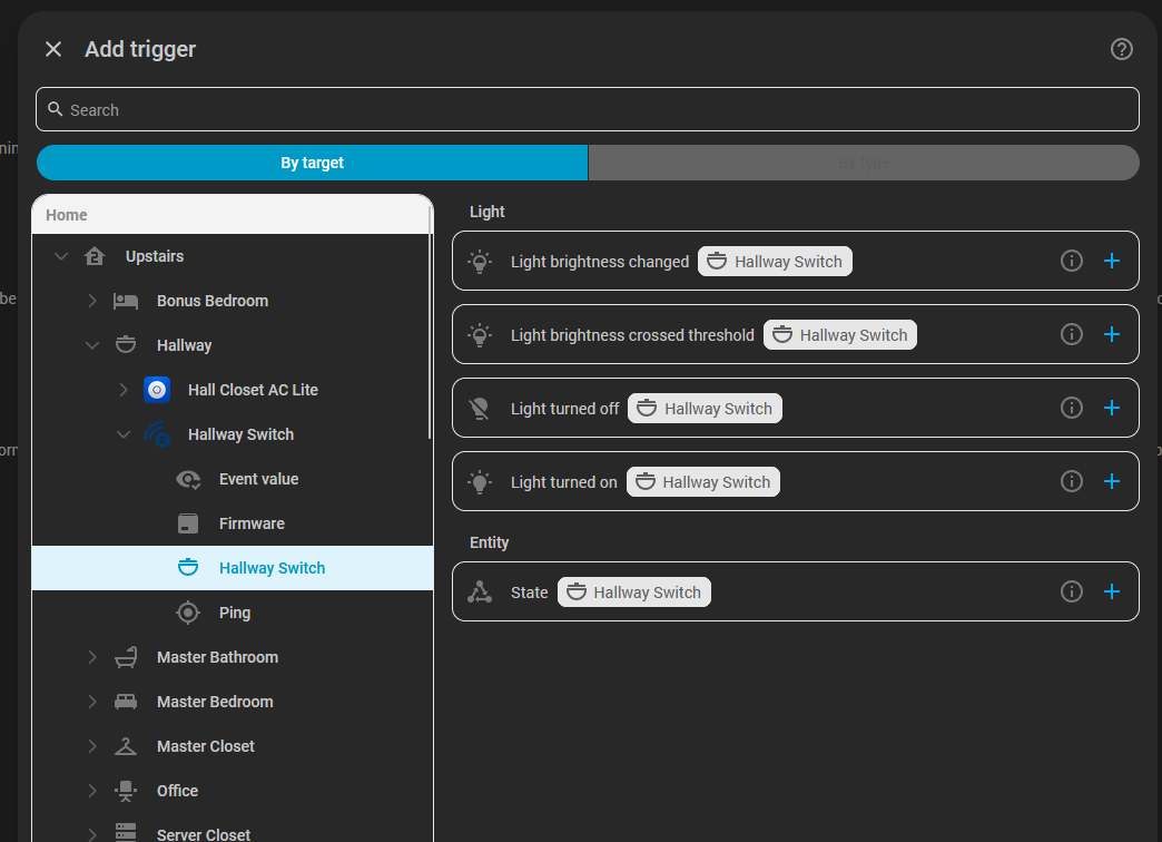

I think you're over complicating this a bit much. This is the default view. (ignore my crappy theme)
Do you think expanding an area to select a device is complicated?

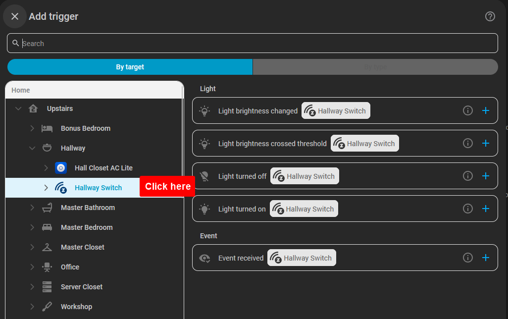

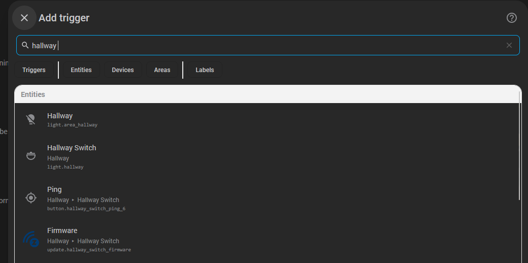

Mind you, you can just search for the device and go from there too:
when clicked brings you here
